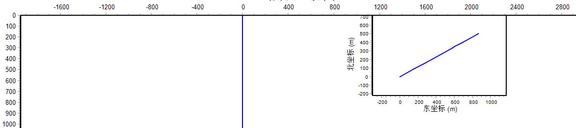

Using TChart and TSubChartToolD draws LineSeries (called MainChart and SubChart). The scales and increment of horizontal and vertical axes are the same, respectively, but the sizes of the two charts are different.
I can determine the Width and Height of the SubChart’s ChartRect from the MainChart.ChartWidth and ChartHeight, but assigning SubChart.Charts[0].Chart.ChartRect.Width and Height does not work. By the way, I think that it is difficult to calculate the size of the SubChart, although assigning the TSubChart.Charts[0].Height and Width works.
How to assign the Width and Height of the SubChart’s ChartRect?

The SubChart and the MainChart are out of proportion in size.
How to make the horizontal and vertical axes of the two charts to be the same scales, respectively?

Taking the horizontal axes as an example. If both of the axes increments of the SubChart and MainChart are 400m, but their sizes are different in pixel (see Fig. above). I hope that the ratio of actual increment and screen increment of the two charts are the same.
The increment is calculated automatically according the space there is to draw labels, it depends always from size of chart, therefore if the size of chart is reduced the increment is recalculating because the labels don't overlap. In your case, a simple solution is try to reduce the SubChart Font Size, because you can show all labels. The line code below shows you how can do it:
ChartTool1.Charts[0].Chart.Axes.Bottom.LabelsFont.Size := 5;
