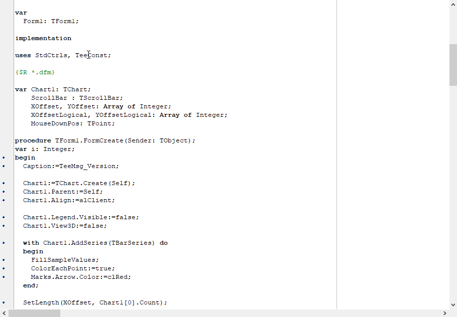

Your project seems to work fine for me with Delphi 7 and TeeChart 8.08.
I only added this code to make sure I'm using the correct TeeChart version:
uses TeeConst;
  Caption:=TeeMsg_Version;

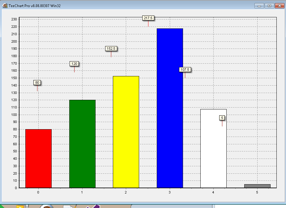

Hmm. Turns out I was using 8.06, but even after I installed 8.08, the resize doesn't work. After the install, my paths all appear to point to 8.08. I am using D2010, not D7. It seems unlikely that is the source of the problem, but I don't know what else?
Resize problem on 8.08e.PNG (31.18 KiB) Viewed 14230 times
Re: Retain custom mark positions on chart resize or tscrollbar
Post by Yeray » Thu Jan 25, 2018 8:04 am
