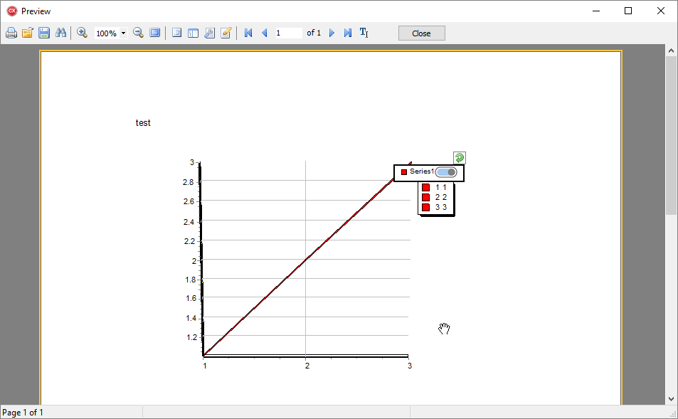

I’m getting an error when target platform is set to Win64 (VCL or FMX) and using a TeeChart in a Fast Reports report.
Fast Reports thinks the problem is in TeeChart.
To get the access violation the chart needs to have some data in it.

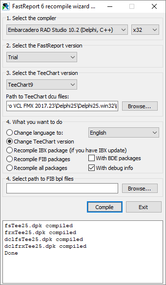

I can build "FastReport 6.0 Tee Components" and "FastScript 1.9 Tee Components" using the recompile.exe tool shipped with Fast Reports 6 Trial version for both win32 and win64.
Then I could drop a TfrxChartObject to a Form in a VCL project, and it compiles without problems in both win32 and win64.
Am I missing anything?

I've been able to run the test application without problems. I just had to copy the fs25.bpl, frx25.bpl, fsTee25.bpl and frxTee25.bpl files, from LibD25 to SysWOW64 and from LibD25x64 to System32 folders.
