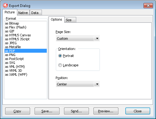

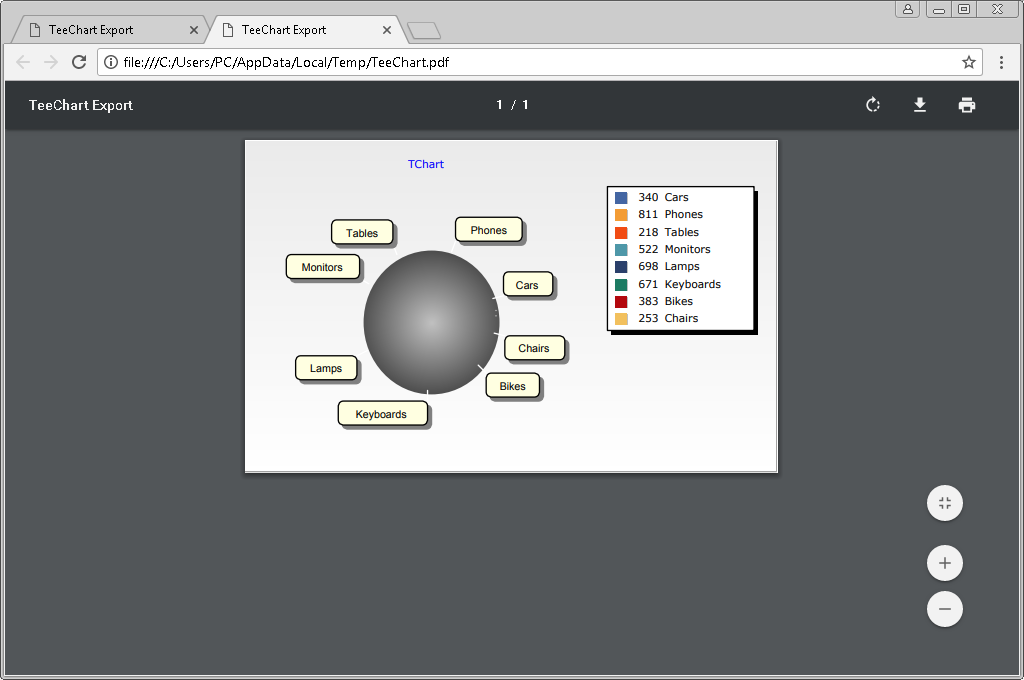

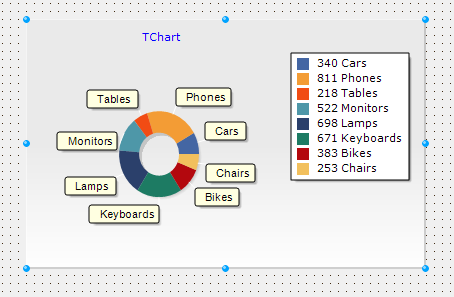

In the attached files I show the chart in a TForm, the export options I select (I don't change any settings) and the PDF export result.
I simply place a new TChart on the screen, add a new Donut series and using the sample data I export the chart to PDF.
This happens when I export a Donut chart from a TForm.

Indeed the export to pdf seems to be broken for the TDonutSeries in 2D. I've added it to the public tracker:
http://bugs.teechart.net/show_bug.cgi?id=2031

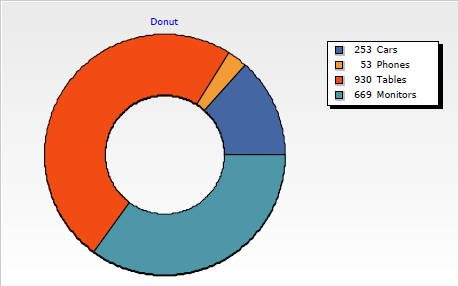

In the meanwhile, it seems you can draw it in 3D and simulate a 2D setting Chart3DPercent to 0 and Elevation to 360:
uses TeePDFCanvas, TeeDonut;
  Chart1.Title.Caption:='Donut';
  with Chart1.AddSeries(TDonutSeries) as TDonutSeries do
    FillSampleValues(4);
    Shadow.Hide;
    Marks.Hide;
  Chart1.Chart3DPercent:=0;
  Chart1.Aspect.Elevation:=360;
  TeeSaveToPDFFile(Chart1, 'C:\tmp\Chart1.pdf');
Here a screenshot of the resultant pdf:
