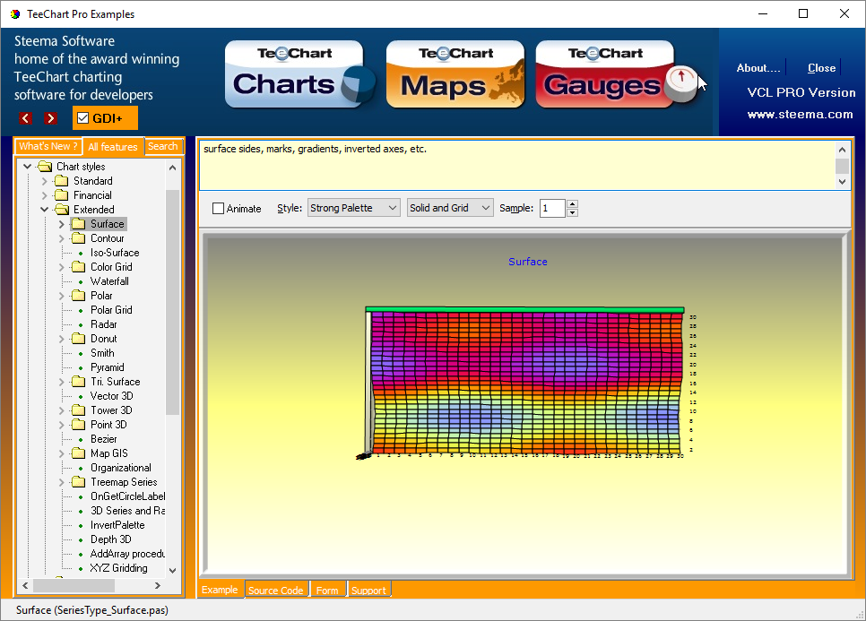

Post by Yeray » Wed Apr 25, 2018 8:59 am
It gives a proportional look when you disable the orthogonal property. Here a surface at 50%:

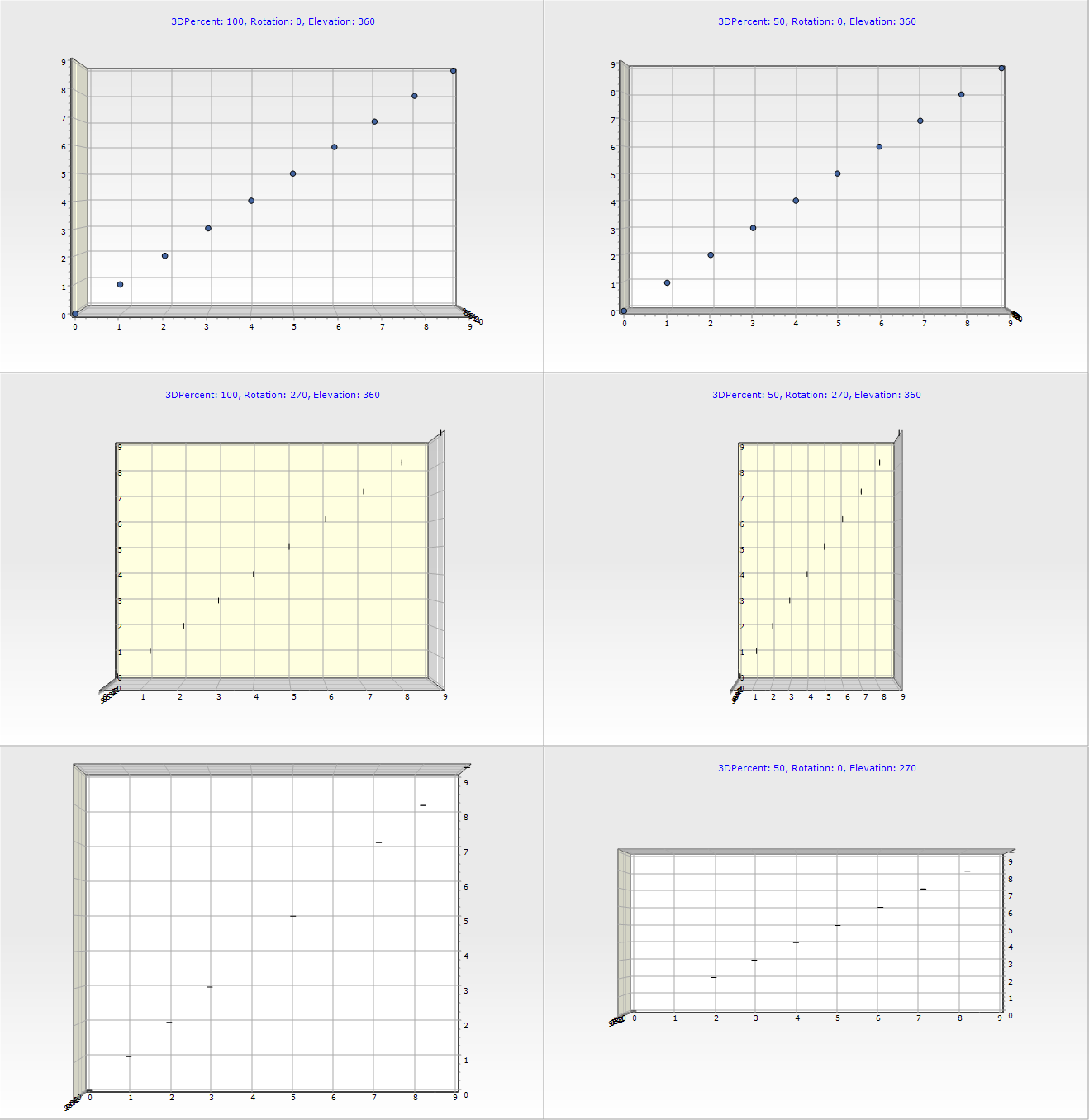

Hello Jim,
As you've observed, the Calculate3Dposition and Calc3DPoint functions are used to calculate 3D positions into canvas positions.
I've done a simple example using a TPoint3DSeries to try to identify what could be wrong in these functions:
uses TeePoin3;
var i: Integer;
  Chart1.Legend.Hide;
  Chart1.Aspect.Orthogonal:=False;
  Chart1.Aspect.Zoom:=80;
  Chart1.Axes.Depth.Visible:=True;
  Chart1.Axes.Depth.Increment:=1;
  Chart1.Axes.Bottom.Increment:=1;
  Chart1.Axes.Left.Increment:=1;
  Chart1.Chart3DPercent:=100; //50;
  Chart1.Aspect.Rotation:=0; //270;
  Chart1.Aspect.Elevation:=360; //270;
  Chart1.Title.Text.Text:='3DPercent: ' + IntToStr(Chart1.Chart3DPercent) +
                          ', Rotation: ' + IntToStr(Chart1.Aspect.Rotation) +
                          ', Elevation: ' + IntToStr(Chart1.Aspect.Elevation);
  with Chart1.AddSeries(TPoint3DSeries) as TPoint3DSeries do
    Pointer.Style:=psCircle;
    LinePen.Hide;
    for i:=0 to 9 do
      AddXYZ(i, i, i);
And I got these screenshots, which seem correct:
