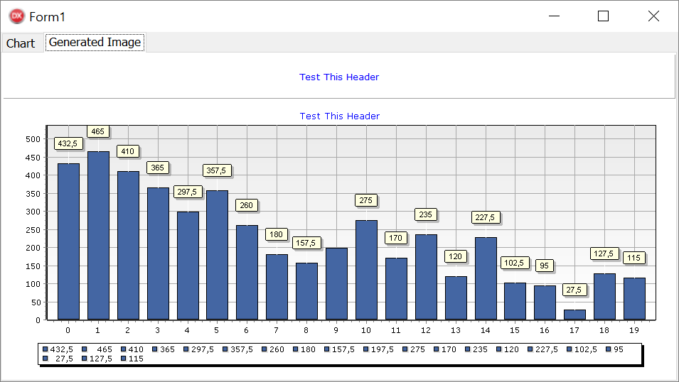

I create images from TCharts to put in my reports (using Digital Metaphors TppReport). Everything is fine when Display/Scale and Input/Change the size of text, apps and other items is at 100%, but when that number changes, all bets are off: fonts appear incorrectly, and the reports simply do not work. It is frustrating.
I have narrowed part of it down to creating imags from TChart (there are some things happening that I haven't quite figured out).
Take a look at the attached demo: when the setting is 100%:
the caption on the chart caption is the correct size (compare it against the size of the TLabel just above it, which is the same font and text):
but when I change it to 200%, the image is rendered without the correct font size:
The report needs the fonts rendered the font size for printing, not for the display settings.
Demo is attached.
Any suggestions on how to get this to work correctly?

Post by Ed Dressel » Fri May 11, 2018 2:15 pm
It is quiet, but by far, this is the biggest problem and support issue with our software. Any suggestions on this? Does Steema recognize it as a bug or is there something I can work on?

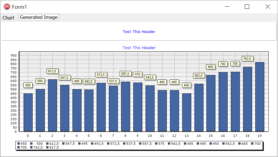

**Finally after years of living wit this bug** I figured out how to recreate the problem without printing, but it was not easy (several hours, including another programmer, just today).
With the attached demo (same as before-but it does have printing features, but won't need that):
1) In the IDE turn off generating a manifest (in Tokyo/Seattle, goo to Project/Options/Application and set Manifest File to "(None)"; similar in Seattle). (Having the auto-generate manifest makes my application unworkable).
2) Build and run the app and view the "Generated Image" tab, which should be showing a bitmap.
3) Now change it from a bitmap to a Metafile. The image is 1/4 the size when viewing 200%.
The image height and width are both the percentage larger as defined by the Display Settings--even though the image is not larger (which, being a metafile, it should not have to be).
Please confirm that you can reproduce this.
Ed Dressel
Image Size.zip
(50.93 KiB) Downloaded 1168 times
