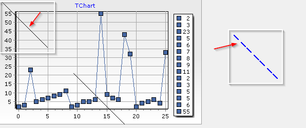

I changed the canvas to GDI, but still printing a solid line without any color. With GDIPlus, it printed the blue colored line. See attached picture: the blue dashed line is from the paintbox which prints well.
  Chart1.Canvas := TTeeCanvas3D.Create;
  Chart1.Canvas.Pen.Handle := ExtCreatePen(PS_GEOMETRIC or PS_USERSTYLE,
                    2, LLogBrush, 4, @LUserstyle);
  Chart1.Canvas.MoveTo(10,10);
  Chart1.Canvas.LineTo(100,100);
  Chart1.Canvas.Line(150,150, 300,300);

Re: Dashed line using ExtCreatePen not working
Post by Yeray » Thu May 17, 2018 10:10 am
I'm sorry, I'm not sure how I tested it. Now I get the same result than you.
TTeeCanvas3D fires DoChangedPen when you modify the Pen.Handle and this recreates the Handle. However, you can get it working as you want by inheriting TTeeCanvas3D and overriding DoChangedPen as follows:
type TMyTeeCanvas3D = class(TTeeCanvas3D)
  protected
    procedure DoChangedPen; override;
procedure TMyTeeCanvas3D.DoChangedPen;
  ReferenceCanvas.Pen.Assign(Pen);
  Chart1.Canvas := TMyTeeCanvas3D.Create;
Find the test project here:
testDashedExtCreatePen.zip
(83.57 KiB) Downloaded 904 times
Post by tremoflo » Thu May 17, 2018 3:10 pm
Thanks Yeray!
in fact, it also works by just assigning ReferenceCanvas.Pen after the assigning the new Pen.Handle as below.
  Chart1.Canvas.ReferenceCanvas.Pen.Assign(Chart1.Canvas.Pen);
