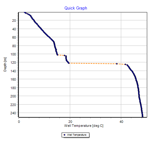

I use TeeChart to present scientific data measured down a geothermal well. With modern equipment, data can be collected at very closeintervals, as small as 6 inches (15 cm) which would result in over 13,000 data points in a series! If all data points are displayed, a solid dark line is displayed.
To overcome this, I have to generate 3 series, a line series, a fastline series and a point series. The line series is not plotted and only used for the legend. I can then limit the number of points that are plotted as shown.
On a typical graph, I might plot up to 20 series. to be able to clearly differentiate, it is necessary to use the full range of presentation features, which includes line type (e.g. solid, dotted, dashed, etc.) However, because of the data density, the dashed line in the example plots as a solid line.
I know this issue has been raised before, and the only solution was to reduce the number of points displayed, using a DownSampling tool. I have not tried this, but I presume it thins the number of points and therefore the fine detail in the curve. I like to display all the data, especially given the very powerful tool in TeeChart where a user can zoom in and examine fine detail very easily.
I think it is time that the FastLine series, at least, was modified to print a uniformly dashed line regardless of the data density. I do not understand why this should be so difficult and it would definitely raise TeeChart credentials as a scientific data charting tool.
I look forward to your comments on this issue.

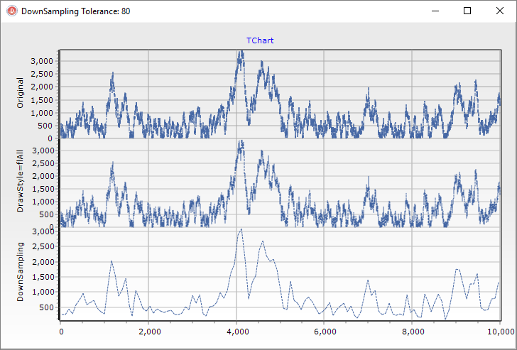

There is also the option to draw the line/fastline series as a polyline. This can be done setting the DrawStyle property to flAll (flSegments is the default). However, as you can see in this simple example doesn't solve the problem:
uses Series, TeeDownSampling;
var dFunc: TDownSamplingFunction;
    dSeries: TFastLineSeries;
var i: Integer;
  Chart1.Legend.Hide;
  Chart1.View3D:=False;
  Chart1.Hover.Visible:=False;
  Chart1.Axes.Left.EndPosition:=33;
  Chart1.Axes.Left.Title.Caption:='Original';
  with Chart1.CustomAxes.Add do
    StartPosition:=33;
    EndPosition:=66;
    LabelsFont.Assign(Chart1.Axes.Left.LabelsFont);
    Title.Font.Assign(Chart1.Axes.Left.Title.Font);
    Title.Caption:='DrawStyle=flAll';
    StartPosition:=66;
    Title.Caption:='DownSampling';
  for i:=0 to 2 do
    with Chart1.AddSeries(TFastLineSeries) as TFastLineSeries do
      if i=0 then
        FillSampleValues(10000)
        DataSource:=Chart1[0];
        CustomVertAxis:=Chart1.CustomAxes[i-1];
        Color:=Chart1[0].Color;
        if i=1 then
          DrawStyle:=flAll
        else if i=2 then
          dSeries:=Chart1[i] as TFastLineSeries;
          dFunc:=TDownSamplingFunction.Create(Self);
          dFunc.DownSampleMethod:=dsAverage;
          dSeries.SetFunction(dFunc);
      Pen.Style:=psDash;
  CalcTolerance;
procedure TForm1.CalcTolerance;
  dFunc.Tolerance:=1;
  Chart1.Draw;
  if dSeries.Count>0 then
    while (Chart1.ChartRect.Right-Chart1.ChartRect.Left) div (dSeries.LastDisplayedIndex-dSeries.FirstDisplayedIndex) < 5 do
      dFunc.Tolerance:=dFunc.Tolerance+1;
      dSeries.CalcFirstLastVisibleIndex;
  Caption:='DownSampling Tolerance: ' + FormatFloat('#,##0', dFunc.Tolerance);
The problem is when you have points so close that there isn't space between them to draw a line and a leave a white space (to have a dash). The only way around I can think on is by reducing the number of points... and thus loosing some precision.

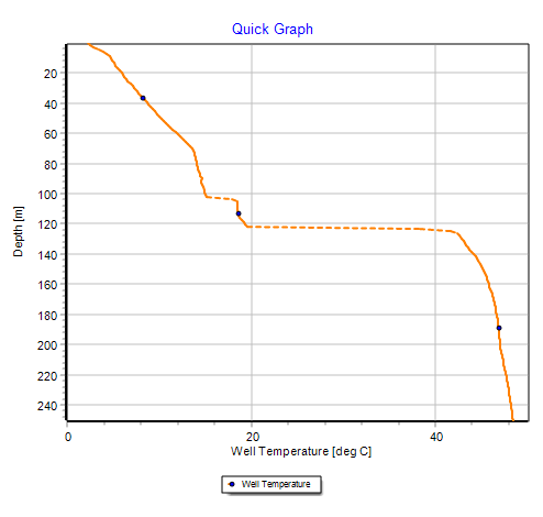

I seem to have solved the problem of displaying dashed line with data-dense series, and that is to use a Line Series rather than a Fast Line Series, and to set DrawStyles to dsAll and Pointer.Visible to False. See attached DashedLines example program. I then use a Point series to draw points at a user-defined density.
I am surprised that a line series has the capability of displaying dashed lines independent of the data density, whereas a Fast Line Series cannot do this. Intuitively, I would have expected the opposite to be true, but I appreciate there is a solution.
My (hopefully final) question is this. Will the chart drawing be significantly slower using Line Series rather than Fast line Series, assuming say 10 series on a graph each with 10,000 data points (but perhaps only 10 points/symbols drawn per series)?
I look forward to your comments.

Thanks for the tests. I think I can live with the slower paint time. Such big data sets are reasonably rare. I have attached the Dashed Lines project, this time with the missing .pas file, just in case anyone wants to review it.
Best regards
