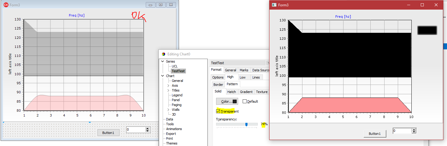

I attach an image which shows how the TChart looks at design time and how it looks like at run time.
So, how to make THighLow series semitransparent?

You can set it by code as follows:
  Series1.HighBrush.Color:=TTeeCanvasClass.ColorFrom(clRed,50);
  Series1.LowBrush.Color:=TTeeCanvasClass.ColorFrom(clGreen,50);
