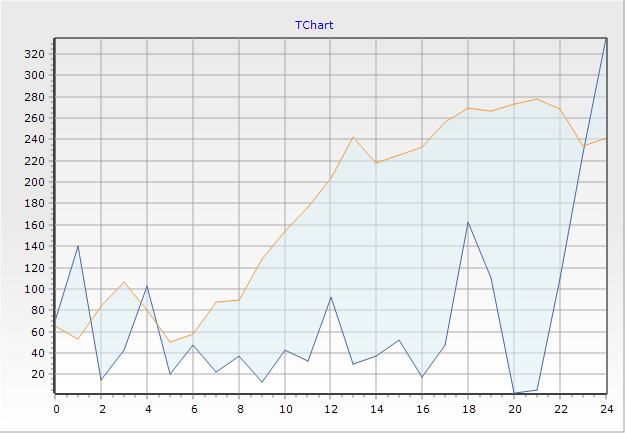

We've tested it here and this seems to work fine here:
Find below the code I've tested with TeeChart Pro VCL/FMX v2018.25 and RAD Studio 10.1 Berlin:
    Chart1->View3D=False;
    Chart1->Legend->Hide();
    Chart1->AddSeries(new TLineSeries(NULL));
    Chart1->Series[0]->FillSampleValues();
    Chart1->Series[1]->FillSampleValues();
    TSeriesBandTool* ChartTool = new TSeriesBandTool(NULL);
    TTeeCustomTool* customTool = Chart1->Tools->Add(ChartTool);
    TSeriesBandTool* Tool = dynamic_cast<TSeriesBandTool*>(customTool);
    Tool->Series = Chart1->Series[0];
    Tool->Series2 = Chart1->Series[1];
    Tool->Brush->BackColor = TColor(16051931);
    Tool->DrawBehindSeries = true;
    Tool->Transparency = 50;
    Tool->Active = true;
What TeeChart version are you using?
Could you please test the code above in a new simple test project?
