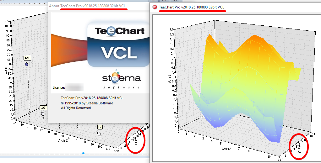

I am using the latest TeeChart version, there seems to be an issue with the depth axis title orientation as there is a difference in the orientation between design time and run time.

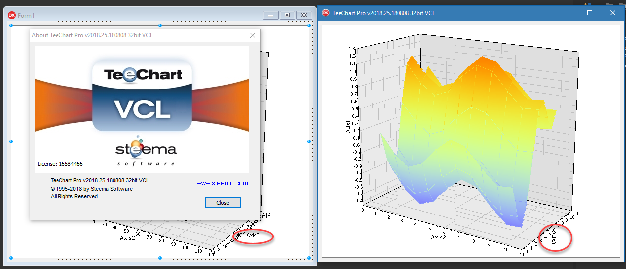

The title of the delphi axis (Axis3) looks the same for me at designtime and at runtime:
Note I've added this to the project to output the TeeChart version that is being used at runtime:
uses TeeConst;
procedure TForm1.FormShow(Sender: TObject);
  Caption:=TeeMsg_Version;
Compare this version with the version the about box gives you at designtime to be sure you are using the same version.

After several TeeChart installations, the designtime package (DclTee*.bpl) in the list of packages is built with the last version, but sometimes there are residual paths in the Library path that make the applications to use an older version at runtime. That's why I asked you to check the TeeChart version at runtime.
This could explain a different behaviour at designtime and at runtime.

FYI axis title orientation is set to zero
Re: 3D depth axis title orientation
Post by Sandra » Tue Oct 30, 2018 5:03 pm
The problem is the same as bug id 2119
Feel free to add your mail to the CC list to be notified when an update arrives.
