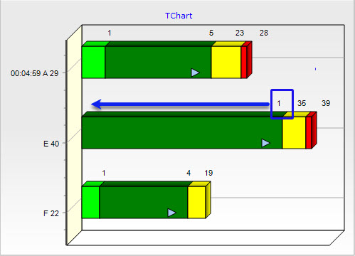

I have a stacked Horizontal Bar series.
I am using custom mark position to place the marks above the bar series. However, despite efforts, the text I want to display shows at the RHS of the bar. How can I show the value at the LHS of the bar?
The values I display are the actual start positions of the bar, so accordingly I want to show them on the chart where each bar segment starts.
MarksLocation := mlStart did not seem to change anything.
APosition:=TSeriesMarkPosition.Create;
  try
  for j := high(IDMRecords.PhaseRecs) downto 0 do
    for i:=0 to PhDataSeries[j].Count-1 do
      if assigned(PhDataSeries[j].Marks.Positions[i]) then
      APosition.Custom:=True;
      PhDataSeries[j].MarksLocation := mlCenter; // mlStart (?);
      APosition.LeftTop.Y:=PhDataSeries[j].Marks.Positions[i].LeftTop.Y - 5;
      APosition.LeftTop.X:=PhDataSeries[j].Marks.Positions[i].LeftTop.X - 30;
      PhDataSeries[j].Marks.Positions[i]:=APosition;
      end; {for i}
    end; {for j}
  finally
  APosition.Free;
Many thanks!

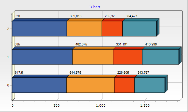

Re: Align Marks Text with start of Horizontal Bar?
Post by Yeray » Thu Nov 15, 2018 10:05 am

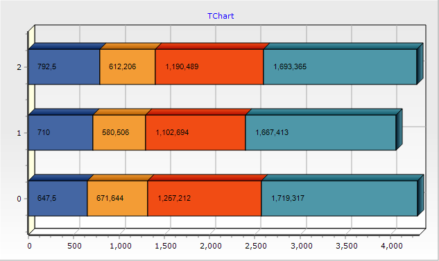

The MarksLocation property is thought to be used with the automatic positioning of the marks, not with the Custom positions you are using.
Ie:
var i: Integer;
  Chart1.Legend.Hide;
  for i:=0 to 3 do
    with Chart1.AddSeries(THorizBarSeries) as THorizBarSeries do
      FillSampleValues(3);
      Marks.Transparent:=True;
      MultiBar:=mbStacked;
      MarksOnBar:=True;
      MarksLocation:=mlStart;
If you want to have your marks at the start but above the bars, you can use the Custom positions as follows:
procedure TForm1.Chart1BeforeDrawSeries(Sender: TObject);
var i, j: Integer;
    APosition: TSeriesMarkPosition;
  try
      with Chart1[i] as THorizBarSeries do
        for j:=0 to Count-1 do
          APosition.LeftTop.Y:=CalcYPos(j) - 20;
          if i=0 then
            APosition.LeftTop.X:=Chart1.Axes.Bottom.IStartPos
            APosition.LeftTop.X:=Chart1[i-1].CalcXPos(j);
          Inc(APosition.LeftTop.X, Chart1.Canvas.TextWidth(ValueMarkText[j]) div 2);
          Marks.Positions[j]:=APosition;
  finally
    APosition.Free;
