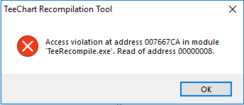

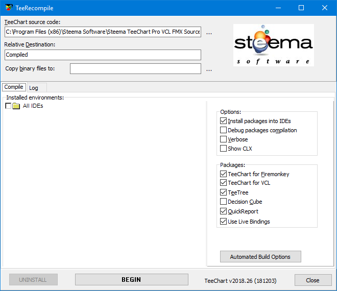

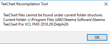

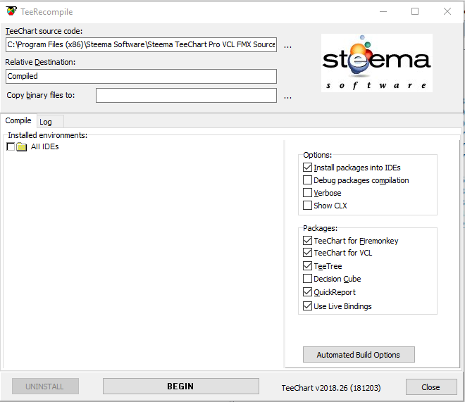

I downloaded the new Version 2018.26 and I installed it. I want to recompile, but when I start TeeRecompile.exe then came an error message see Clipboard01.png. Then I choose the source folder. Now I can't see my enviroment: Rio (Clipboard02.png)

Re: TeeChart VCL/FMX 2018.26 Install in Rio
Could you please check if you have any of these keys?
"HKEY_CURRENT_USER\Software\Embarcadero\BDS\20.0"
"HKEY_LOCAL_MACHINE\Software\Embarcadero\BDS\20.0"
These are the places TeeRecompile checks to extract the IDE information ("Edition" string and "RootDir" path to find the compiler). When this information is found, an item in the TeeRecompile Tree is created.

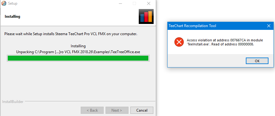

I downloaded it and installed it, but with TeeInstall.exe i have an error messages see Clipboard03.png.
Clipboard04.png path is not correct at end is .win32 -> c:\Program Files (x86)\Steema Software\Steema TeeChart Pro VCL FMX 2018.26\Delphi26\Delphi26.win32\

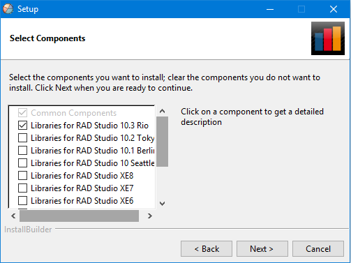

I have tried to install the binary version but it didn't work.
However, this version does offer the option to select the proper Delphi version (the source code version doesn't) and it takes longer to install but fails anyway.

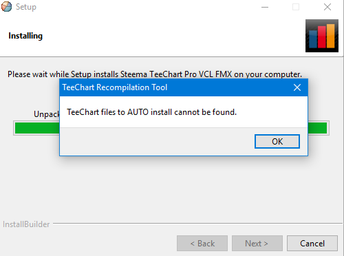

Not fixed with new installer. After the AV pops up a dialog to browse with the folder for TeeChart Sources. Don't know if theis helps finding the error.

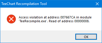

I have tried the latest installer and it still doesn't work.
- No option to select the Delphi version in the staller
- TeeRecompile crashes
- No option to select the Delphi version in TeeRecompile
