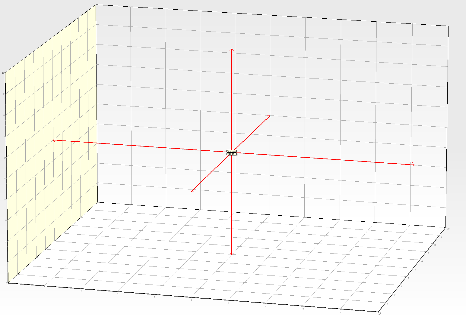

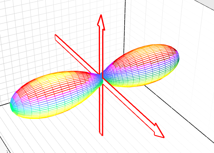

How can I draw nice 3D arrows like in the attached picture?
By using the code below I only get "flat" arrows
and can't draw an arrow in Z direction:

Re: How can I draw nice 3D Arrows to depict axes (a,b,c)
Post by Yeray » Mon Feb 18, 2019 9:11 am

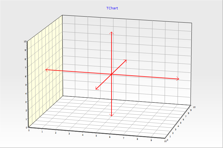

You can give it a try at the Vector series. Ie:
uses TeeSurfa;
  with Chart1 do
    Chart3DPercent:=100;
    Aspect.Orthogonal:=False;
    Aspect.Zoom:=70;
    Legend.Hide;
    Axes.Left.SetMinMax(0,10);
    Axes.Bottom.SetMinMax(0,10);
    Axes.Depth.SetMinMax(0,10);
    Axes.Depth.Visible:=True;
    Axes.Left.Increment:=1;
    Axes.Bottom.Increment:=1;
    Axes.Depth.Increment:=1;
  with Chart1.AddSeries(TVector3DSeries) as TVector3DSeries do
    Color:=clRed;
    Pen.Width:=2;
    ArrowHeight:=10;
    ArrowWidth:=10;
    AddVector(5,5,5,0,5,5,'', clRed);
    AddVector(5,5,5,10,5,5,'', clRed);
    AddVector(5,5,5,5,0,5,'', clRed);
    AddVector(5,5,5,5,10,5,'', clRed);
    AddVector(5,5,5,5,5,0,'', clRed);
    AddVector(5,5,5,5,5,10,'', clRed);

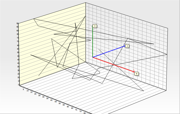

Ok, that makes them appear, but all the Labels are displayed together at the center point, please see the screenshot:
How Can I display the labels at the end of the Arrows?
The Arrowheads I would expect to be shown as a (3D) Cone, see below:

Ok, that is about making it nice, but what about the markers/labels, how can I get these displayed correctly?
Post by Yeray » Thu Feb 21, 2019 3:55 pm
axrDegen wrote:
Wed Feb 20, 2019 12:42 pm
Sorry, I missed that point.
You could use marks custom positioning at OnGetMarkText event. Ie:
procedure TForm1.VectorGetMarkText(Sender:TChartSeries; ValueIndex:Integer; var MarkText:String);
  if Assigned(Sender) and (ValueIndex>-1) and (ValueIndex<Sender.count) and
     Assigned(Sender.Marks.Positions) and Assigned(Sender.Marks.Positions[ValueIndex]) then
    with TVector3DSeries(Sender), Marks.Positions[ValueIndex] do
      Custom:=True;
      LeftTop:=ParentChart.Canvas.Calculate3DPosition(CalcXPosValue(EndXValues[ValueIndex]),
                                                      CalcYPosValue(EndYValues[ValueIndex]),
                                                      ParentChart.Axes.Depth.CalcPosValue(EndZValues[ValueIndex]));

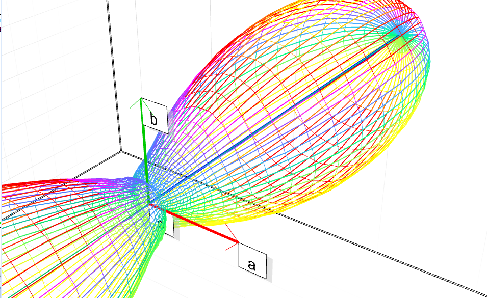

Thank you Yeray, that works for X and Y but not for Z, please see screenshot:
Note that I use the Min/Max of another series to calculate the Max values for the Vectors, like that:
    MaxX := Max(FPoint3DSeries.MaxXValue, Abs(FPoint3DSeries.MinXValue));
    MaxY := Max(FPoint3DSeries.MaxYValue, Abs(FPoint3DSeries.MinYValue));
    MaxZ := Max(FPoint3DSeries.MaxZValue, Abs(FPoint3DSeries.MinZValue));
    FAxesSeries.AddVector(0,0,0, MaxX,0,0, 'a', clRed);
    FAxesSeries.AddVector(0,0,0, 0,MaxY,0, 'b', clGreen);
    FAxesSeries.AddVector(0,0,0, 0,0,MaxZ, 'c', clBlue);
How to solve that ?

Thank you, but this doesn't work. I am finally painting the axes labels in the OnAfterDraw event like that:
    XCent := FAxesSeries.CalcXPosValue(0);
    YCent := FAxesSeries.CalcYPosValue(0);
    ZCent := aChart.Axes.Depth.CalcPosValue(0);
    XPosi := FAxesSeries.CalcXPosValue(FXAxisMax);
    YPosi := FAxesSeries.CalcYPosValue(FYAxisMax) - aChart.Canvas.TextHeight('b');
    ZPosi := aChart.Axes.Depth.CalcPosValue(FZAxisMax);
    aChart.Canvas.TextOut3D(XPosi, YCent, ZCent, 'a');
    aChart.Canvas.TextOut3D(XCent, YPosi, ZCent, 'b');
    aChart.Canvas.TextOut3D(XCent, YCent, ZPosi, 'c');
Post by Yeray » Mon Feb 25, 2019 11:39 am
axrDegen wrote:
Mon Feb 25, 2019 11:17 am
That's another possibility. Does it work as you want?
axrDegen
Posts: 31
Joined: Mon Jan 14, 2019 12:00 am
Post by axrDegen » Mon Feb 25, 2019 12:34 pm
Yes, that works very well
