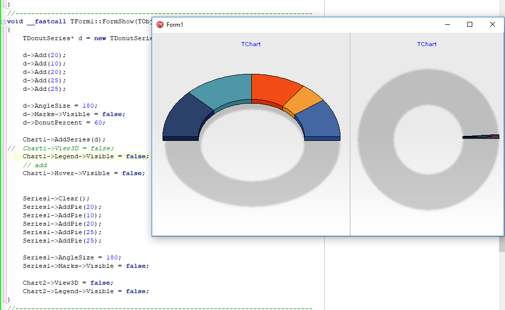

Just trying to work out an issue I'm getting with the TDonutSeries when using the DonutPercent value which used to display correctly on an older TChart version but getting an issue with v2018.26.181203.
Code example is :-
	TDonutSeries* d = new TDonutSeries(Chart1);
	d->Add(20);
	d->Add(10);
	d->Add(20);
	d->Add(25);
	d->Add(25);
	d->AngleSize = 180;
	d->Marks->Visible = false;
	d->DonutPercent = 60;
	Chart1->AddSeries(d);
	Chart1->View3D = false;
	Chart1->Legend->Visible = false;
	// add
	Chart1->Hover->Visible = false;
	Series1->Clear();
	Series1->Add(20);
	Series1->Add(10);
	Series1->Add(20);
	Series1->Add(25);
	Series1->Add(25);
	Series1->AngleSize = 180;
	Series1->Marks->Visible = false;
	Chart2->View3D = false;
	Chart2->Legend->Visible = false;
Which produces an image like this on the left with the items all crammed together rather than spread out around the donut ?

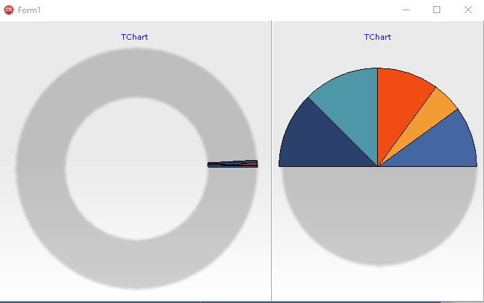

Actually just realized when I was playing around I had changed the Series1 to a TPieSeries.
When I change that back to a TDonutSeries it draws all together as well.
But question is the same, why is the dount not spread around the series ?
If I turn on 3D it displays correctly but not when 2D ?

Image example :-
