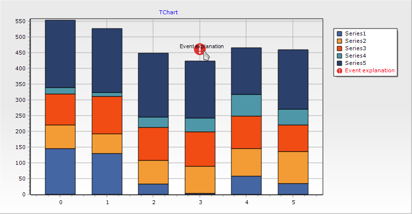

An option would be using a TRectangleTool and a TAnnotationTool. Ie:

But, if you want to show the icon in the legend you should use an extra series, ie an TImagePointSeries, and then you can use it to draw the icon and text on the chart. Ie:

Thank you for this. I played with it a little bit and like the solution--but sometimes the icon is cut off of the chart:
You can reproduce this in the attached demo (simply put the icon on the tallest stack).
Is there a way to fix this? It would be nice if there wasn't unnecessary margin? created.

You can set a MaximumOffset to the left axis, ie after setting the InflateMargins to false (line 117):
      Pointer.InflateMargins:=False;
      GetVertAxis.MaximumOffset:=Pointer.VertSize;

That is pretty slick. I don't understand it but it works.
