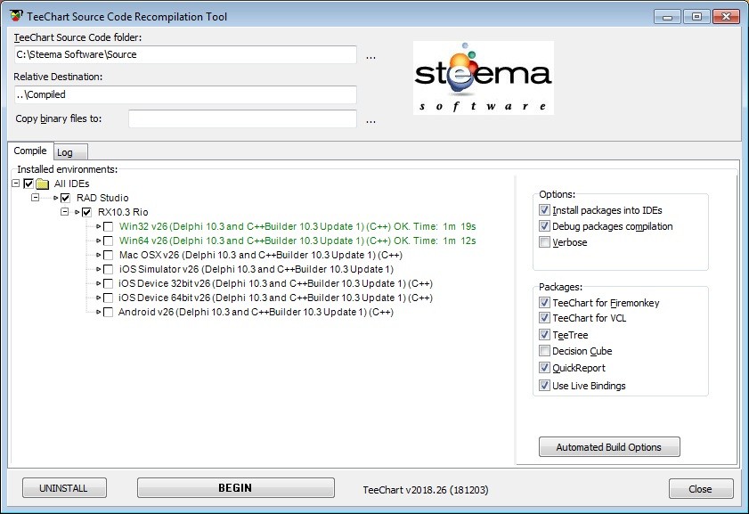

I am using the install file TeeChartVCLFMXSOURCE-2018.26.exe and it ends up running TeeRecompile.
In TeeRecompile, I chose the options you can see here:
Everything looks like it worked. So I create a new Windows VCL project in Rio, and drop the TChart component on the form in the designer, as usual. Nothing else on the form at all, and I don't add any series to the TChart or anything.

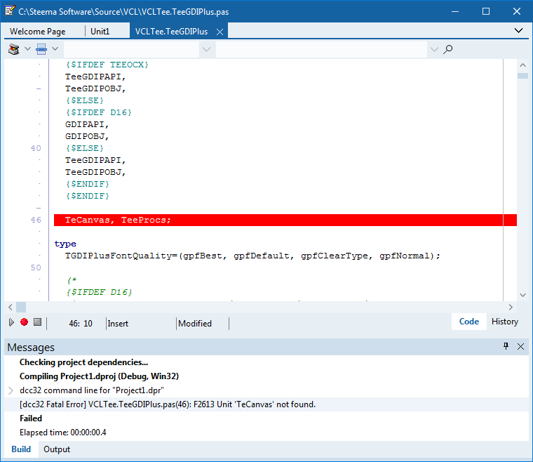

The problem comes when I try to compile.
I get an error, "[dcc32 Fatal Error] VCLTee.TeeGDIPlus.pas(46): F2613 Unit 'TeCanvas' not found."
The IDE shows that this is imported in unit VCLTee.TeeGDIPlus:

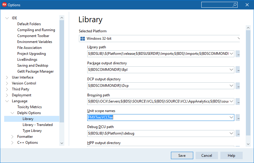

Please, add the "VCLTee" and/or "FMXTee" prefix to the unit scope names in your IDE:
You can add them at the project options, but if you do it at IDE-level, any new project will be able to use them.
Sorry for the inconvenience generated.

Post by chartist » Fri Mar 15, 2019 10:58 pm
That fixed it - thank you Yeray! :D
