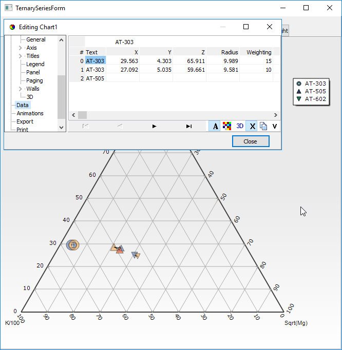

I am having continuing problems assigning the Weighting parameter in a ternary graph, as follows:
1. If I do not assign this parameter, the graph does not draw.
2. If I assign it to the Weight field from my input memory table (derived from a csv file), the Weighting value is set to zero, and the Y field is filled with the Weight values.
3. If I assign the parameter to the same field as the Radius parameter, the Weighting is still zero, but at least the Y field is filled to the correct values.
I have attached a simple example project that shows these effects. I would be grateful if you could indicate what I am doing wrong here.
Many thanks
Errol
TernaryGraph_Weight.zip
(8.82 KiB) Downloaded 1757 times

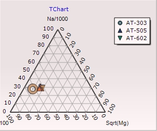

After a long break, I am back again, still trying to get ternary graphs to work.
I am writing to express my disappointment in the implementation of Ternary Graphs. We use ternary graphs to display the relationship between three data values in exactly the same way as we use regular XY graphs to display relationships between two data values. For XY graphs, we place a Chart or DBChart on a form and then send series of xy pairs to it, and have developed substantial code to handle symbols, colours, connecting lines and so on. We can easily set the axis scales to “zoom in” to show a small part of the chart in cases where there is dense data and have good control over the legend.
However, when using a ternary graph, this functionality does not seem to be available. Each series places a new ternary chart on the form, inside the previous chart, and each of which has fixed axes (0 to 100%). I understand that I can use an event to draw each chart on top of the previous chart, which is fine, but an additional complication. The legend seems to have limited functionality, and there is a Weight parameter which I still do not understand.
I would have preferred a structure more similar to a regular XY chart, that could be placed on the form and then use the equivalent of your standard line series, but requiring the definition of XValues, YValues and ZValues. If this was the case, then we could use much of our existing code to create ternary graphs. However, I presume that you have progressed too far in your development of ternary graphs to change to a form that is more compatible with regular XY graphs.
I have downloaded the TernaryGraph_Weight.zip attachment of 4 April 2019, and have got it to work - thanks. However, I do not seem to be able to alter the radius or the colours of the symbols. Also, I want to treat the data in the attached csv file as three separate series based on the name of the well, each series with a separate symbol, but with different colours for each data point. Also, I would like the option to draw a line between the data points of each series, in date order.
Any help you can give me would be greatly appreciated, or point me in the direction of the members of the TernarySeries component (i.e. the properties and methods).
I look forward to hearing from you soon.
I'm sorry to hear that. The Ternary series is a quite particular series that draws elements (like axes) in it's own way so it doesn't receive improvements and fixes made in other parts of the chart as other series do.
If you can help us to identify and report with detail any issue you may find with it, it would help us to improve this specific series.

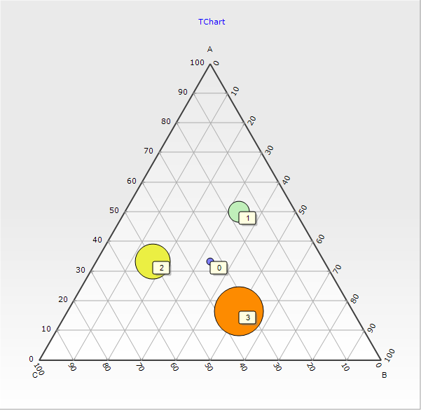

The weight list is used to fill the colors of the points in range and palette styles. The point with the lowest weight is drawn with the end color in the palette, the point with the highest weight value is drawn with the start color in the palette, and the rest of points are drawn with a color calculated by extrapolation.

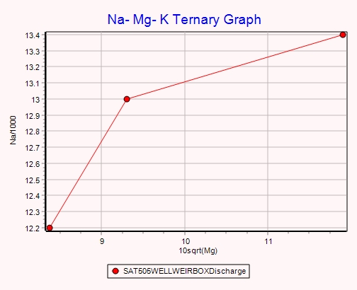

I am still having great difficulty in producing a ternary chart by code. I have attempted to implement the various events of the Ternary Chart test program in case I am missing some important steps, but to no avail. I acknowledge that I am using components that you do not use, but I still feel that you should be able to pinpoint what I am doing wrong.
I use the following code to implement a graph using a simple line series. This works correctly, showing that the data is correctly obtained from the memory table.
 procedure TQSCollection.InsertTernarySeries(aFieldName, aCalcField: array of string; dID: integer);
var
  sTitle,A,B,C: string;
  iIndex, iData: integer;
  sTitle := self.Owner.fMultiGraphList.Strings[dID];
  iIndex := 0;
  if (SeriesListT.IndexOf(sTitle) = -1) then
    SeriesListT.AddObject(sTitle, TLineSeries.Create(Owner));
    iIndex := SeriesListT.IndexOf(sTitle);
    with TLineSeries(SeriesListT.Objects[iIndex]) do
      IniFile := fIniFile;
      ParentChart := self.Owner.Chart;
      DataSource := TDataset(self.Owner.fMultiGraphList.Objects[dID]);
      Name := GetValidName(sTitle);
      YValues.ValueSource := aCalcField[0];
      XValues.ValueSource := aCalcField[1];
      XValues.Order := loNone;
      YValues.Order := loNone;
      self.Owner.Chart.Axes.Left.Automatic := True;
      self.Owner.Chart.Axes.Bottom.Automatic := True;
      self.Owner.Chart.Axes.Bottom.Labels := True;
      self.Owner.Chart.Axes.Left.Title.Text := aCalcField[0];
      self.Owner.Chart.Axes.Bottom.Title.Text := aCalcField[1];
      Pointer.Style:=psCircle;
      Pointer.Visible := True;
      ShowInLegend := True;
      self.Owner.Chart.Legend.TextStyle := ltsPlain;
      self.Owner.Chart.Legend.Title.Visible:=true;
  end
    DeleteSeries(SeriesListT.IndexOf(sTitle));
The results are shown on the accompanying graphic.

The way the Ternary Series was devised was to use 5 components:
X,Y,Z values and Radius and Weight.
X,Y and Z position the point as a measure of proportionality of each of the three values. Radius decides the visible radius of the point and Weight uses a colour scale.
This code then plots four points, one equidistant from each axis (centered) and the other offset proportionally as per their values:
procedure TForm13.Button1Click(Sender: TObject);
  Series1.AddBubbleXYZWeight(10,10,10,5,1,clTeeColor);
  Series1.AddBubbleXYZWeight(30,20,10,15,2,clTeeColor);
  Series1.AddBubbleXYZWeight(20,10,30,25,3,clTeeColor);
  Series1.AddBubbleXYZWeight(10,30,20,35,4,clTeeColor);
  Series1.UsePalette := True;
  Series1.TernaryStyle := tsBubble;
  Series1.Marks.Style := smsPointIndex;
output:
TernarySeries won't share the chart with other series types so they need to be Active:=False;

Thank you for your reply. A ternary graph requires three values to calculate relative percentages, but only two values need to be plotted on a ternary graph as the third value is automatically 100 - A - B (working in percentages) as you state. If you use a regular XY chart with with the Y value at 60°and fixed ranges of 0 to 100 on each axis, and plot A on the Y axis on a line parallel with the X-axis and B on the X-axis on a line parallel with the y-axis, then the point is in exactly the same position as you obtain in your formulation.
Early work by Giggenbach, a geochemist in the geothermal industry, used this technique. If you search for "Giggenbach ternary diagrams", you will see many images, some with Mg plotted on the bottom axis going from left to right, and others with Mg on the right axis going from top to bottom. The positions of the points in either format are identical - the 10% line can either be projected from the bottom axis at a 6o° angle or from the right axis at -60°. (Note that Giggenbach used the regular X-Y plot initially as the graphing tools he had available had the option to draw the y-axis at an angle other than 90°).
Therefore, a ternary graph formulation using regular line, point and fastline series but with a 60° Y-axis and with a special A-B-C axis format, would be much more compatible with regular graphing used elsewhere.
However, I have another question. In the test program (TernaryGraph_Weight.zip) provided earlier in this thread, the code is shown below. In this code, I do not understand how Chart1[ i ] is created. When I try to emulate this code, I cannot create an "apparent" array of charts, which I presume is why I am not getting any output.
I look forward to your comments.
Best regards
Errol
Firstly, your project has highlighted a bug between SeriesTextSrc and the Ternary Series. I noticed it when looking at the Y values reported in the data section of the Editor. Y is coming up as the Weighting value. That's because (the bug) SeriesTextSrc uses what's called the MandatoryValueList for its second value. For most Series Types Y is mandatory (ie a chart could be created with x as a sequential index but Y needs to have some significance). For the case of Ternary X,Y,Z are all treated as equals and it's Weight that shows the true value difference and that was chosen to be Mandatory. That's being erroneously picked up by SeriesTextSource.
I put in a temporary fix for your project which generates the Chart image attached. Notice that Ternary points have moved respectively. We'll revise how best to apply this fix for inclusion with the next release update.
That doesn't answer your question though.
Your test project loads via SeriesTextSource to several Series. Have you considered loading this as one Series?
