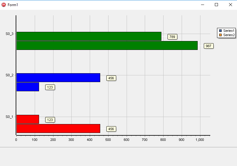

1. In code below groups group nothing on chart.
2. Chart1.SeriesGroups.Items[0].Add(Series_0); does not add the series. I have to invoke Chart1.AddSeries(Series_0);
to get series to show. Why doesn't Chart1.SeriesGroups.Items[0].Add(Series_0); add the series?
I want two groups with 3 items in each. See screen shot below. Using TeeChart is not intuitively obvious. I used it years ago w/Delphi 5 and do not remember complications and misunderstanding of properties/methods.
As written, code produces no output displayed in chart.
Robert

Got up this am and chart produced with Chart1.AddSeries(Series_0); commented out. Mysterious gremlins at work.
Never the less how do I get the two series bars grouped together
and why don't the S1_1 series labels show on the chart???

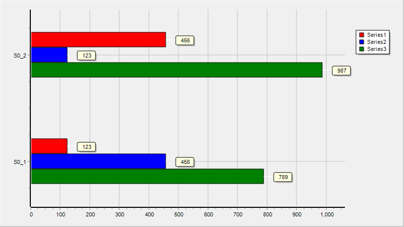

You can find an explanation at the TeeChart VCL Reference, concretely, for TSeriesGroups:
Chart Series can be grouped. Series groups can optionally be displayed at the chart editor.
The main purpose of groups is to have an easy way to show or hide multiple series, that is, show or hide individual groups of series.
A single series can pertain to no groups, to one group or to more than one group.
If you want to have 3 bars and 3 bars, you should have three series with two values each:
    Series_0 := THorizBarSeries.Create(Self);
    Series_0.CustomBarHeight := 30;
    Series_0.BarWidthPercent := 200;
    Series_0.Marks.Style := smsValue;
    Series_0.Color := clRed;
    Series_1 := THorizBarSeries.Create(Self);
    Chart1.AddSeries(Series_1);
    Series_1.CustomBarHeight := 30;
    Series_1.BarWidthPercent := 200;
    Series_1.Marks.Style := smsValue;
    Series_1.Color := clBlue;
    Series_2 := THorizBarSeries.Create(Self);
    Chart1.AddSeries(Series_2);
    Series_2.CustomBarHeight := 30;
    Series_2.BarWidthPercent := 200;
    Series_2.Marks.Style := smsValue;
    Series_2.Color := clGreen;
    Series_0.Add(123, 'S0_1');
    Series_1.Add(456, 'S1_1');
    Series_2.Add(789, 'S2_1');
    Series_0.Add(456, 'S0_2');
    Series_1.Add(123, 'S1_2');
    Series_2.Add(987, 'S2_2');

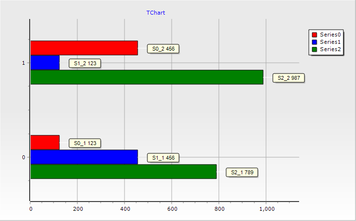

Here is how you could create the bars and assign a Name to each one dynamically.
I've also set the series marks to show the labels and the values (smsLabelValue) and the left axis labels to show the values (talValue).
  Chart1.View3D := False;
  Chart1.View3DWalls := False;
  Chart1.Axes.Left.LabelStyle:=talValue;
  for i := 0 to 2 do
    with Chart1.AddSeries(THorizBarSeries) as THorizBarSeries do
      Name := 'Series' + IntToStr(Chart1.SeriesCount-1);
      Marks.Style := smsLabelValue;
  Chart1[0].Color := clRed;
  Chart1[1].Color := clBlue;
  Chart1[2].Color := clGreen;
  Chart1[0].Add(123, 'S0_1');
  Chart1[1].Add(456, 'S1_1');
  Chart1[2].Add(789, 'S2_1');
  Chart1[0].Add(456, 'S0_2');
  Chart1[1].Add(123, 'S1_2');
  Chart1[2].Add(987, 'S2_2');
A group of series in TeeChart only groups series objects to show them in the legend, activate or deactivate a set (a group) of series or to show groups instead of series in the chart editor.
The series groups in TeeChart don't modify the drawing of the bars/points. The bars and points are always draw respecting their values. In the case of bar series, all the values with the same xvalue (yvalues for horizbar series) are drawn side by side (when using the default mbSide MultiBar style), but these are not "series groups".
On the other hand, note toy cannot cast a string to a THorizBarSeries. Check this.

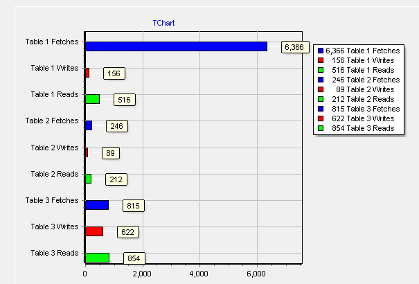

New using groups which supposedly don't group. Not sure about that.
type
  TForm1 = class(TForm)
    Chart1: TChart;
  private
    { Private declarations }
  public
    { Public declarations }
var
  Form1: TForm1;
  Series1, series2, series3 : THorizBarSeries;
  BaseSeries                : THorizBarSeries;
implementation
{$R *.dfm}
var g1,g2,g3:TSeriesGroup;
    Position : TMultibar;
  Position := mbSide;
  Chart1.Pages.MaxPointsPerPage := 10;
  BaseSeries := THorizBarSeries.Create(Self);
  BaseSeries.CustomBarHeight := 15;
  BaseSeries.MultiBar := Position;
  BaseSeries.ParentChart := Chart1;
  BaseSeries.Depth := 100;
  BaseSeries.BarWidthPercent := 20;
  BaseSeries.Marks.Style := smsValue;
  BaseSeries.OffsetPercent := 50;
  Series1 := BaseSeries;
  Series2 := BaseSeries;
  Series3 := BaseSeries;
  Chart1.AddSeries(Series1);
  Chart1.AddSeries(Series2);
  Chart1.AddSeries(Series3);
  g3:=Chart1.SeriesList.AddGroup('Table 3');
  g3.Series.Add(Series3);
  with series3  do
      AddBar(854,'Table 3 Reads',clLime);
      AddBar(622,'Table 3 Writes',clRed);
      AddBar(815,'Table 3 Fetches',clBlue);
  g2:=Chart1.SeriesList.AddGroup('Table 2');
  g2.Series.Add(Series2);
  with series2 do
      AddBar(212,'Table 2 Reads',clLime);
      AddBar(89,'Table 2 Writes',clRed);
      AddBar(246,'Table 2 Fetches',clBlue);
  g1:=Chart1.SeriesList.AddGroup('Table 1');
  g1.Series.Add(Series1);
  with Series1 do
      AddBar(516,'Table 1 Reads',clLime);
      AddBar(156,'Table 1 Writes',clRed);
      AddBar(6366,'Table 1 Fetches',clBlue);
end.
And using groups (Does it work?)
The problem of course is to dynamically fill with varying number of table/series and the associated data.

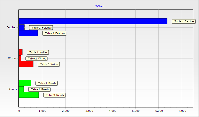

Post by Yeray » Tue Apr 09, 2019 12:00 pm
In this example you've posted, both BaseSeries, Series1, Series2 and Series3 point to the same series. So you are adding just one series and adding all the points to the same.
I have the impression that, what you would expect groups to be, is just the ValueIndex in the TeeChart Series.
Here using the same values with three HorizBarSeries:
uses Series;
var i: Integer;
  Chart1.View3D:=False;
  Chart1.Legend.Visible:=False;
  for i:=0 to 2 do
      CustomBarHeight := 25;
      OnGetMarkText:=SeriesMarkText;
  with Chart1[2] as THorizBarSeries do
    Title:='Table 3';
    AddBar(854,'Reads',clLime);
    AddBar(622,'Writes',clRed);
    AddBar(815,'Fetches',clBlue);
  with Chart1[1] as THorizBarSeries do
    Title:='Table 2';
    AddBar(212,'Reads',clLime);
    AddBar(89,'Writes',clRed);
    AddBar(246,'Fetches',clBlue);
  with Chart1[0] as THorizBarSeries do
    Title:='Table 1';
    AddBar(516,'Reads',clLime);
    AddBar(156,'Writes',clRed);
    AddBar(6366,'Fetches',clBlue);
procedure TForm1.SeriesMarkText(Sender: TChartSeries; ValueIndex: Integer; var MarkText: string);
  MarkText:=Sender.Title + ': ' + MarkText;
If you still find problems with it, please post an image showing how would you expect the chart to be and I will try to prepare an example.

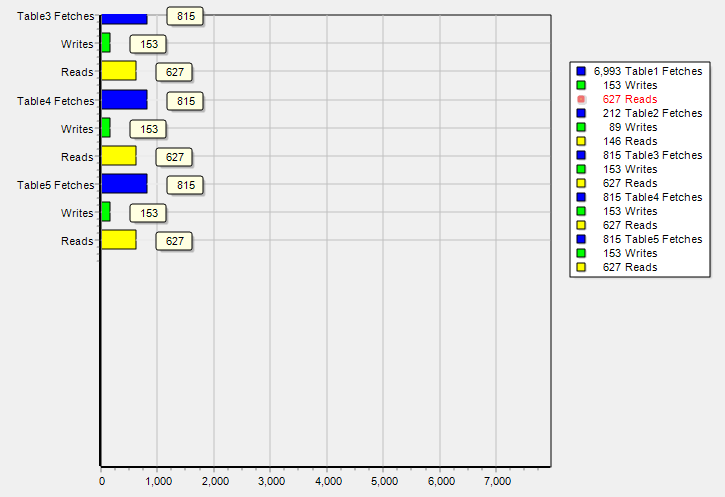

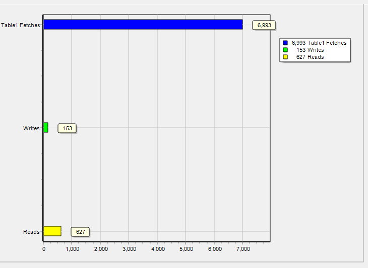

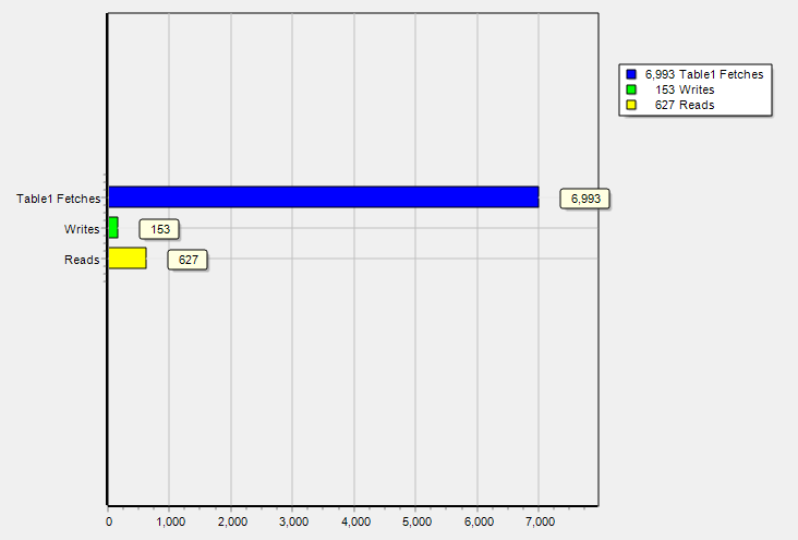

Got actual program working with groups

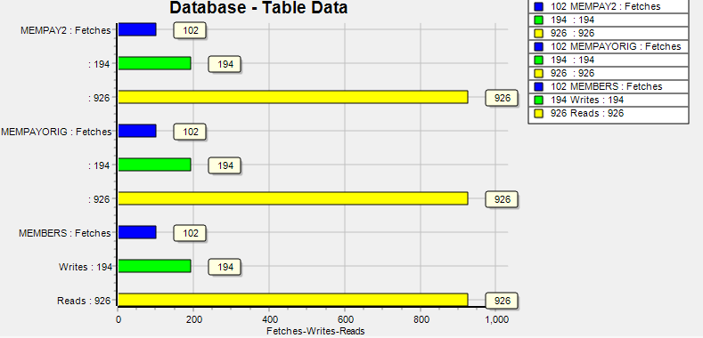

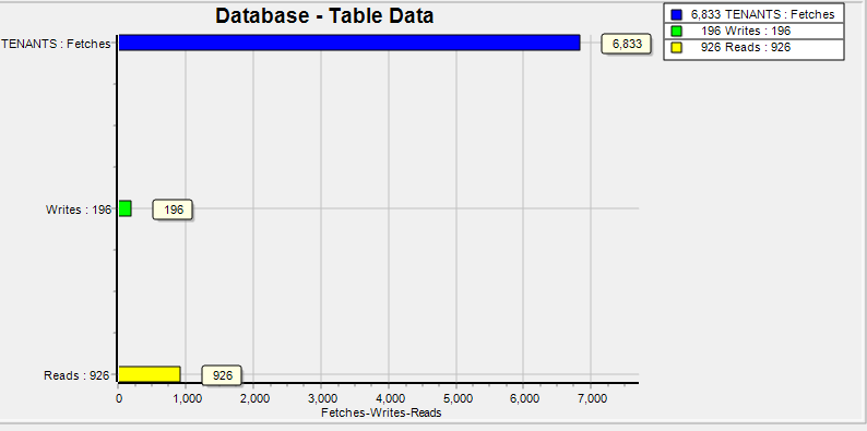

Now to figure out how to get rid of all the space between bars with only single table.
Re: Trying to figure out TeeChart
Post by Yeray » Thu Apr 11, 2019 11:42 am
tultalk wrote:
Wed Apr 10, 2019 12:37 pm
Great!
You may be clearing some series and the chart keeps reserving space for them to be drawn.
Try hiding the empty series.
If you still find problems with it, please arrange a simple example we can run as-is to reproduce the problem here.

Here is work program where I test dfm attached with zip extension Change to dfm
unit gSeries_Unit1;
interface
uses
  Vcl.Controls, Vcl.Forms, Vcl.Dialogs, VclTee.TeeGDIPlus, VCLTee.TeEngine,
  Vcl.ExtCtrls, VCLTee.TeeProcs, VCLTee.Chart, VCLTee.Series, Vcl.StdCtrls,
  Vcl.Buttons;
type
    Panel1: TPanel;
    btnFillChart: TBitBtn;
    procedure btnFillChartClick(Sender: TObject);
  private
  public
var
  Form1: TForm1;
  Chart1 : TChart;
  newGroup       : TSeriesGroup;
  newSeries      : THorizBarSeries;
  series0, Series1, series2, series3,series4 : THorizBarSeries;
  BaseGroup  : TSeriesGroup;
  valTable  : String; //TChartValueList;
  valFetches : Integer;//TChartValueList;
  valWrites : integer; // TChartValueList;
  namWrites :String;
  valReads  : integer; //TChartValueList;
  namReads  : String;
implementation
{$R *.dfm}
procedure TForm1.btnFillChartClick(Sender: TObject);
var
    i,iCount       : integer;
  Chart1 := TChart.Create(Panel1);
  Chart1.Parent := Panel1;
  Chart1.Height := 514;
  Chart1.Width := 745;
  Chart1.View3D := false;
//  Chart1.Pages.MaxPointsPerPage := 15;
  Position := mbSideAll;
  namWrites := 'Writes';
  namReads  := 'Reads';
  BaseGroup := TSeriesGroup.Create(Chart1.SeriesGroups);
  BaseSeries := THorizBarSeries.Create(Chart1);
  Chart1.AddSeries(BaseSeries);
  BaseSeries.CustomBarHeight := 20;
  BaseSeries.OffsetPercent := 0;
{Create data}
  iCount := 0;
  for i := iCount downto 0 do
      newGroup := BaseGroup;
      newGroup.DisplayName := 'group' + IntToStr(i);
      newSeries := BaseSeries;
      newSeries.Name := 'Series' + IntToStr(i);
      if i = 0 then
          valTable := 'Table1 Fetches';
          valFetches := 6993;
          valWrites := 153;
          valReads := 627;
        end
      else if i = 1  then
          valTable := 'Table2 Fetches';
          valFetches := 212;
          valWrites := 89;
          valReads := 146;
        end
      else if i = 2  then
          valTable := 'Table3 Fetches';
          valFetches := 815;
          valWrites := 153;
          valReads := 627;
        end
      else if i = 3  then
          valTable := 'Table4 Fetches';
          valFetches := 815;
          valWrites := 153;
          valReads := 627;
        end
      else if i = 4  then
          valTable := 'Table5 Fetches';
          valFetches := 815;
          valWrites := 153;
          valReads := 627;
 {Popuilate chart}
          with Chart1 do
                  newGroup := Chart1.SeriesList.AddGroup(newGroup.Name);
                  newGroup.Series.Add(newSeries);
                  with newSeries do
                      AddBar(valReads,namReads,clYellow);
                      AddBar(valWrites,namWrites,clLime);
                      AddBar(valFetches, valTable,clBlue);
              Pages.MaxPointsPerPage := ((iCount + 1)*3);
end.
Produces:
gSeries_Unit1.zip
(663 Bytes) Downloaded 1641 times

Post by tultalk » Fri Apr 12, 2019 12:47 pm
So from reading, one way would be to fill chart with series and hide them?
How would one hide the series?
Secondly:"The SideMargins property controls if first and last displayed Bar will be separated from the Chart rectangle. By default, margins are set to half the sum of all Bar Series bar widths."
By default, margins are set to half the sum of all Bar Series bar widths. Half the sum of all Bar Series bar widths? Looks to me like is sets it at
half of Bar Series bar width, not half the sum of all???
tultalk
Posts: 13
Joined: Wed Mar 20, 2019 12:00 am
Post by tultalk » Fri Apr 12, 2019 2:49 pm
Hi:
I set
     Chart1.Axes.Left.SetMinMax(-iCount -4,iCount+4); <--------------------------------------
             for i := iCount downto 0 do ,,,,,
and
                      SideMargins := true; <---------------------------------------------
The spacing is Ok (Single series centered) but multiple series up to high concealing upper series.
I thought side margins controlled that so entire series would be centered?
Setting Chart1.AllowPanning := pmNone; does not help except prevent scrolling to the hidden series.

Post by tultalk » Fri Apr 12, 2019 7:59 pm
Works fine now. Acceptable spacing etc. Tested w 1-> 8 series
