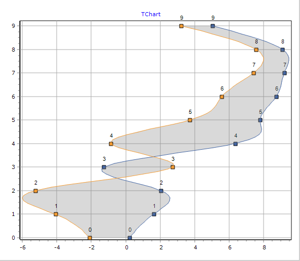

Check out this simple example:
I only had to exchange the X and Y values between the source point series and the horizline series:

Note I've used the Smoothed property of the LineSeries above. If you want to use a SmoothingFunction (ie to control the Factor), you'll need two extra HorizLine series. Here an example (I'm not showing a screenshot because it looks exactly as above):
