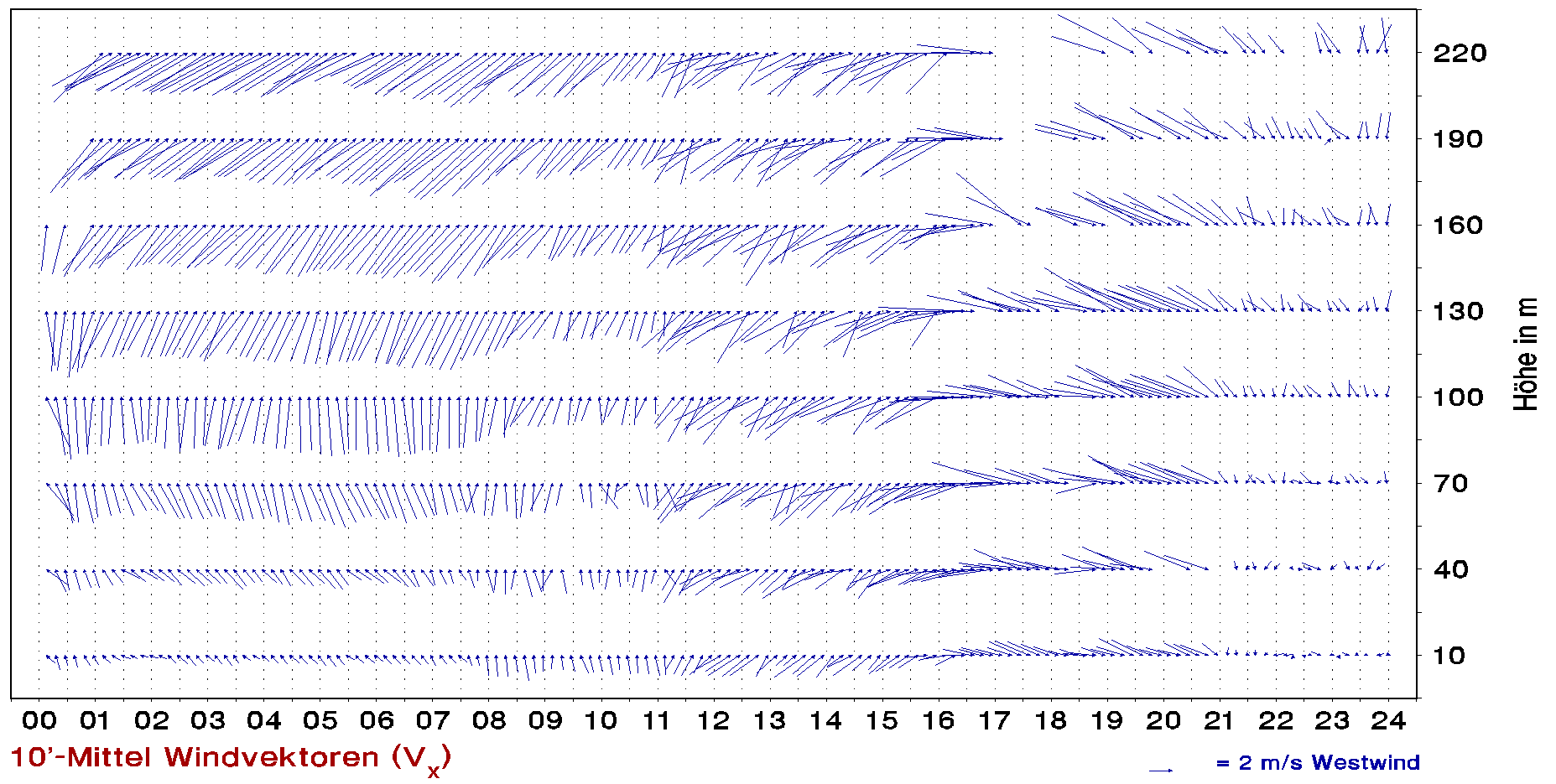

is it possible to create a wind vector plot similiar to the attached picture?
Each arrow in the picture represents the wind speed and wind direction at a given time and height.
I tried a little bit using the TArrowSeries, but I did not get a satisfactory solution.
Has anyone good ideas for that problem?

Hello jradke,
This code simplifies a how-to. Add 3 ArrowSeries to a Chart and run the code in a button. My example calculations aren't up to much, just to give an idea.
Y location ArrowStart gives height above sea-level, X ArrowStart location is the timestamp and the end of each arrow would be calculated as your take on wind-strength and direction.
Var i, a : Integer;
    aaX, aaY, f1,f2,f3, aDate : Double;
    point : TPoint;
  procedure getDirection(var aX, aY : double; aDate, force, direction : double);
  var opp, adj : double;
  Begin
    //trig val calculate using force and direction
    //direction here just as angle.
    //this is where the work is to calculate, Arrow Series fits to start and end x,y locations
    opp := force * Sin(DegToRad(direction));
    adj := force * Cos(DegToRad(direction));
    aX := aDate + adj;
    aY := opp;
  For i:=0 to Chart1.SeriesCount-1 do
    Chart1.SeriesList[i].Clear;
  Chart1.LeftAxis.SetMinMax(0,5);
  aDate := 44173;      //simplifying a timestamp as double
  For a := 0 to 50 do
  Begin
    aDate := aDate + 1;
    f1 := Random(10) / 7 ;
    getDirection(aaX,aaY,aDate,f1,120 - random(90));
    Series1.AddArrow(aDate,1,aaX,1+aaY);
    f2 := Random(10) / 7;
    getDirection(aaX,aaY,aDate,f2,90 - random(90));
    Series2.AddArrow(aDate,2,aaX,2+aaY);
    f3 := Random(10) / 7;
    getDirection(aaX,aaY,aDate,f3,70 - random(90));
    Series3.AddArrow(aDate,3,aaX,3+aaY);
I hope that helps.

Hello Mark,
this seems to be an interesting approach, I will continue to work with it.
To calculate the correct length of the arrows I think I have to convert it to pixel size (depending on the screen resolution).
Thanks for the tip.
