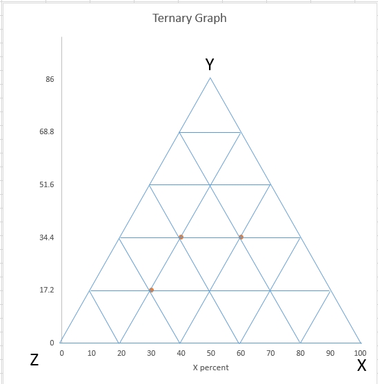

As you know, I am quite disappointed with the Ternary Series implementation in TeeChart. A ternary plot is simply an X-Y plot, as there are only 2 independent variables (Z is always equal to 100 - X% - Y% where X% = X/(X+Y+Z)*100 and Y% = Y/(X+Y+Z)*100. This means there is no need to use 3D charting code. In fact, ternary data can be plotted on a simple X-Y chart, but it doesn't look so good and is less easy to understand, so special triangular exes are employed.

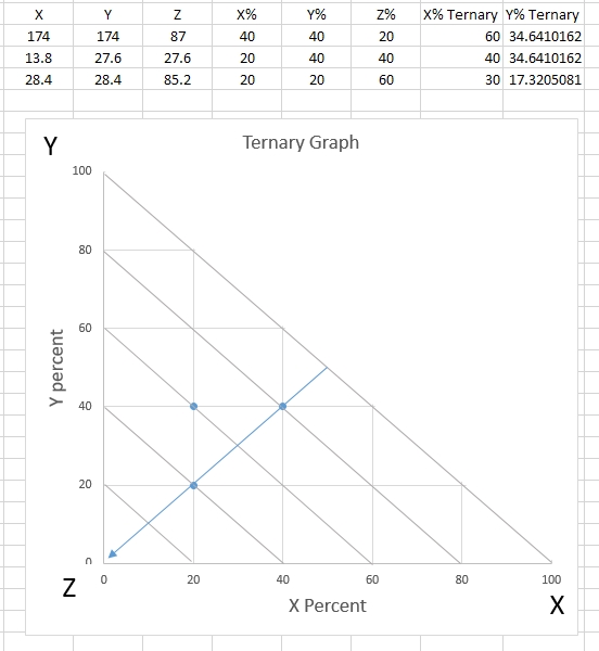

I have attached a spreadsheet which shows my thinking. On the first spreadsheet, data is plotted on a simple X-Y plot. The Z-axis is in the direction of the blue arrow, at right-angles to the diagonal edge of the chart. As you can see, the Z-values are correctly located at 80, 60 and 40% respectively, as shown below.
In the second sheet, I have drawn sloping "axes", and again plotted X-Y data. To do this, the X% and Y% values need to be recalculated using the following formulae:
X% Ternary = X% + Y% * cos(60°)
Y% Ternary = Y% * sin(60°)
Examining the chart, it is clear that the X%, Y% and Z% values are plotted correctly.
Finally, XValues (in Delphi) data should always correspond to the value at the right vertex of the graph, and YValues data to the top vertex of the graph. In the current formulation, XValues corresponds to the top vertex and YValues to the right vertex, apparently following the clockwise rotation of the axes in one configuration. however, the order or rotation of the axes is arbitrary, and the true axis direction for each vertex is a line from the mid-point of the side opposite the vertex to the corresponding vertex. It is just convention to draw the axis on one adjacent side of the triangle or the other. In the third spreadsheet, I have shown three axis configurations commonly in use, an apparent clockwise rotation, and anti-clockwise rotation and where just the x-axis and the y-axis are shown. The data is plotted in exactly the same place for all three configurations. The important aspect is the location of the vertex, so whatever is at the right vertex uses XValues and whatever is at the top axis uses YValues.

Thank you for your reply and comments. Perhaps I haven't explained myself clearly enough. I still expect to be able to use three variables, X, Y and Z in a Ternary Chart, but the chart code will automatically convert these to three relative variables using the following formulae:
X% = X/(X + Y + Z)*100
Y% = Y/(X + Y + Z)*100
Z% = Z/(X + Y + Z)*100
Note that there are now only 2 independent variables, as Z% always equals 100 - X% - Y%, so for the actual graphing, only X% and Y% need to be plotted. A ternary plot is really just an X-Y plot but with special triangular axes. If you plot the following values on a regular X-Y chart, they will be located in the correct position within the triangular axis space.
X%" = X% + Y% * cos(60°)
Y%" = Y% * sin(60°)
So, placing a TTernarySeries or a TTernaryPointSeries on a regular chart would do the following:
1. Calculate X% and Y% from X, Y and Z.
2. Plot X%" and Y%".
3. Draw triangular axes (once only), with three options of either clockwise, anticlockwise or X-Y axes.
To draw lines on a ternary chart to demarcate various areas of interest, the user would use just two values, which would correspond to X% and Y%. For instance, to draw a vertical line bisecting the chart into two halves, the line would go from 50,0 to 0,100.
I think this should work, and the user can then easily go from X-Y plots to ternary plots with the same data and same presentation.
