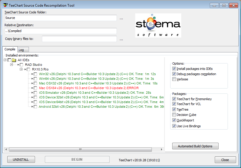

I encountered an error when installing the latest TeeChart VCL, into a clean copy of Windows 7 and a fresh install of RAD Studio 10.3.2 Rio.
The compilation failed for Mac OSX64, as you can see here:
Steema Install Error.png (56.39 KiB) Viewed 14141 times

Any thoughts on what could be happening here?
