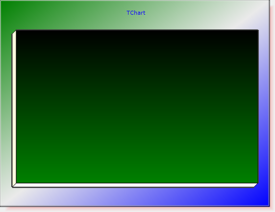

Re: Gradients not showing if endcolor is set
Greetings,
Your code with a new TeeChart on a new form, brings up a Chart that appears ok as per the code itself.
I'm using TeeChart Pro; I'll setup a machine with access to Standard but I wouldn't expect a difference.

procedure TForm14.FormCreate(Sender: TObject);
Chart1.View3D := True;
Chart1.Gradient.Direction := gdDiagonaldown;
Chart1.Gradient.StartColor := ClGreen;
Chart1.Gradient.EndColor := ClBlue;
Chart1.Gradient.Visible := True;
Chart1.Walls.Back.Gradient.StartColor := ClBlack;
Chart1.Walls.Back.Gradient.EndColor := ClGreen;
Chart1.Walls.Back.Transparent := False;
Chart1.Walls.Back.Gradient.Visible := True;
Chart1.Walls.Back.Visible := True;
Chart1.Shadow.Color := ClRed;
Chart1.Shadow.HorizSize := 10;
Chart1.Shadow.VertSize := 10;
Chart1.Border.Visible := True;

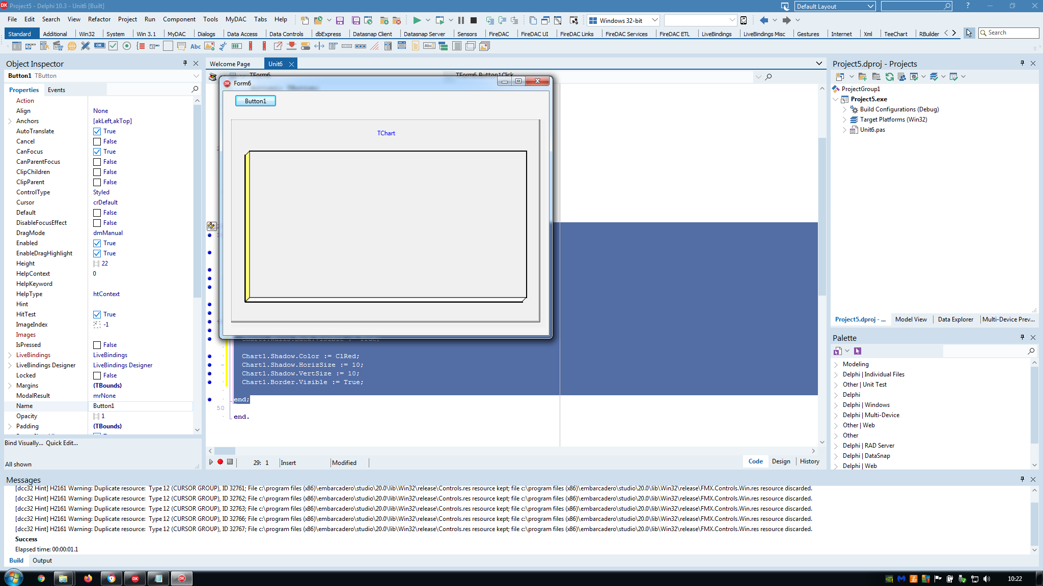

procedure TForm6.Button1Click(Sender: TObject);

- Project.png (178.55 KiB) Viewed 30942 times

..as a followup, I notice compiler messages in your project
This is a VCL project, correct? I can't say I have an explanation for the message but it raises a question mark.
Someone on this thread came across the message in a VCL project too and there is a suggestion as to the cause.
Look for "I get the same warning error for my VCL program" in
https://forums.embarcadero.com/thread.j ... dID=256302
The issue may not be related but it is a possibility.
c:\program files (x86)\embarcadero\studio\20.0\lib\Win32\release\Controls.res resource kept; file c:\program files (x86)\embarcadero\studio\20.0\lib\Win32\release\FMX.Controls.Win.res resource discarded.
Hi Marc,
I have fixed the discarded error and still the same.
I have uploaded the zipped version on the exe and a file called "code.txt" that is all the code from the test project
I hope this helps as I am confused
Best Regards
Nigel (Cyprus)
Best Regards
Nigel (Cyprus)

Still no luck
This acts just the same as before.
This is the exact code from my project now, there are no errors but also no changes to the chart when I click the button.
Any other thoughts?
Hi Marc,
I have just run a VCL only project and the button click works for the win32 forms, I can set gradients etc okay.
Run a FMX project with the same calls and the same problem exists:-(
Not sure where to go from here
Nigel (Cyprus)
Nigel (Cyprus)
Got it working !!!!!!
Not too sure why yet, but made some changes to the Uses and FMX stuff and it now works
Many thanks you for all your time with this problem.
I hope not to come back to you
Nigel
(Cyprus)
Nigel
(Cyprus)
Ok, good to hear it's resolved.
