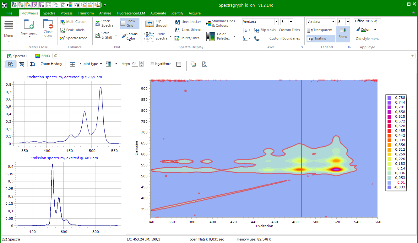

Hi there,
I use a TContourseries to plot 2D spectral data. While hovering with the mouse, it always paints a red higlighted trace for all contours that have the same z value as the current mouse position. With contours of complex shape, this slows down the program extremely. I also use a cursor tool, to let the user extract cross sections, and this gets unusable in this mode. I then have to switch to TColorGridSeries, which doesn't have the problem, obviously.
I really don't need that contours highlighted, but couldn't find a property or method to turn this behaviour off. Any advise?

- screenshot_highlighted_contourlines.png (88.19 KiB) Viewed 18200 times

O.M.G. This is awesome, the speed increase is tremendous. It now reacts nearly realtime even for large data sets (like 1700 x 6500 data points).
Thank you very much!
