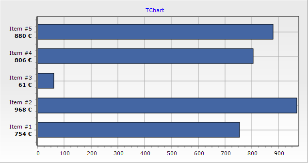

Attached is a simple demo where the horizontal series caption has two lines. Works fine.
My customer wants two modifications that I do not know how to do:
1) They would like the left axis labels to be right-aligned.
2) They would the second line (the value) bolded.
Are either of those possible?

Is this what you are trying to achieve?
This is the code I used to draw the above:
constructor TForm1.Create(aOwner: TComponent);
var
  lValue: currency;
  I: Integer;
  lCaption: string;
  inherited;
  for I := 1 to 5 do begin
    lValue := Trunc(Random(1000));
    lCaption := Format('Item #%d'+sLineBreak+'<b>%.0m</b>', [I, lValue]);
    Series1.AddBar(lValue, lCaption, clTeeColor);
  Chart1.Axes.Left.LabelsFormat.TextAlignment:=taRightJustify;
  Chart1.Axes.Left.LabelsFormat.TextFormat:=ttfHtml;
As you can see I'm using Html format to customize part of the labels. Note there was a bug I've just fixed: #2294.

That's cool... but I don't know how you did that--attached is my demo that neither right aligns the values not bolds the items.
What am I doing wrong?

Re: Labels for horizontal series
Post by Yeray » Fri Mar 13, 2020 11:41 am
You missed this part in your code:

Post by EdDressel » Fri Mar 13, 2020 5:12 pm
Perfect. Thank you.
