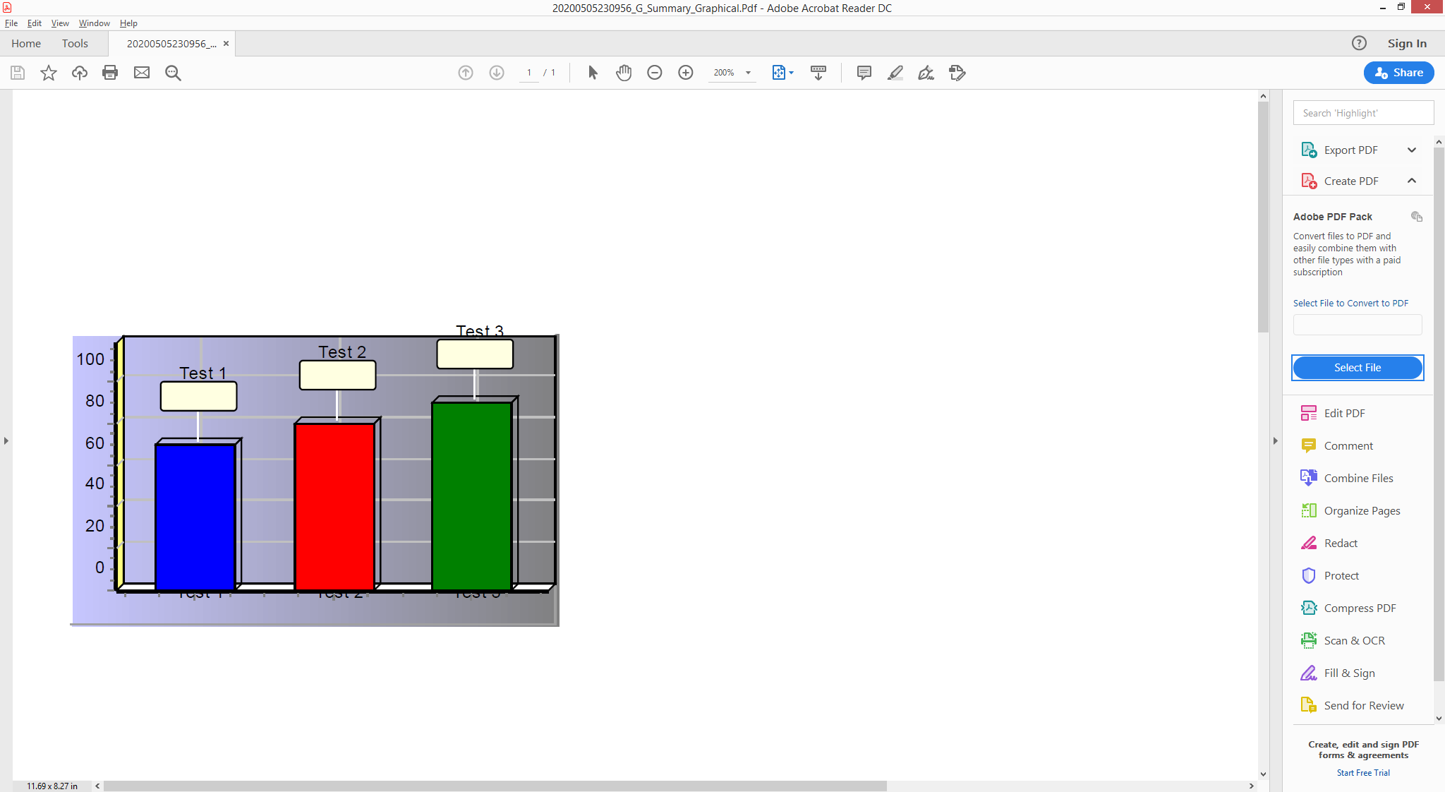

Has anyone else had the problem with ALL the text on the chart being offset?
I have attached an image to show the problem as it is exported to a metafile, this is where the problem lies, exporting as a bmp file works ok

I've just tested it in a simple project and it seems to work fine for me here.

Hi and thanks for your reply,
I have managed to use the export as BMP option to a memory stream and loaded the image into my PDF from the memory stream and everything is ok and in the right place, it looks to only be a problem with export to metadata. so no need for any follow up for me thanks.
