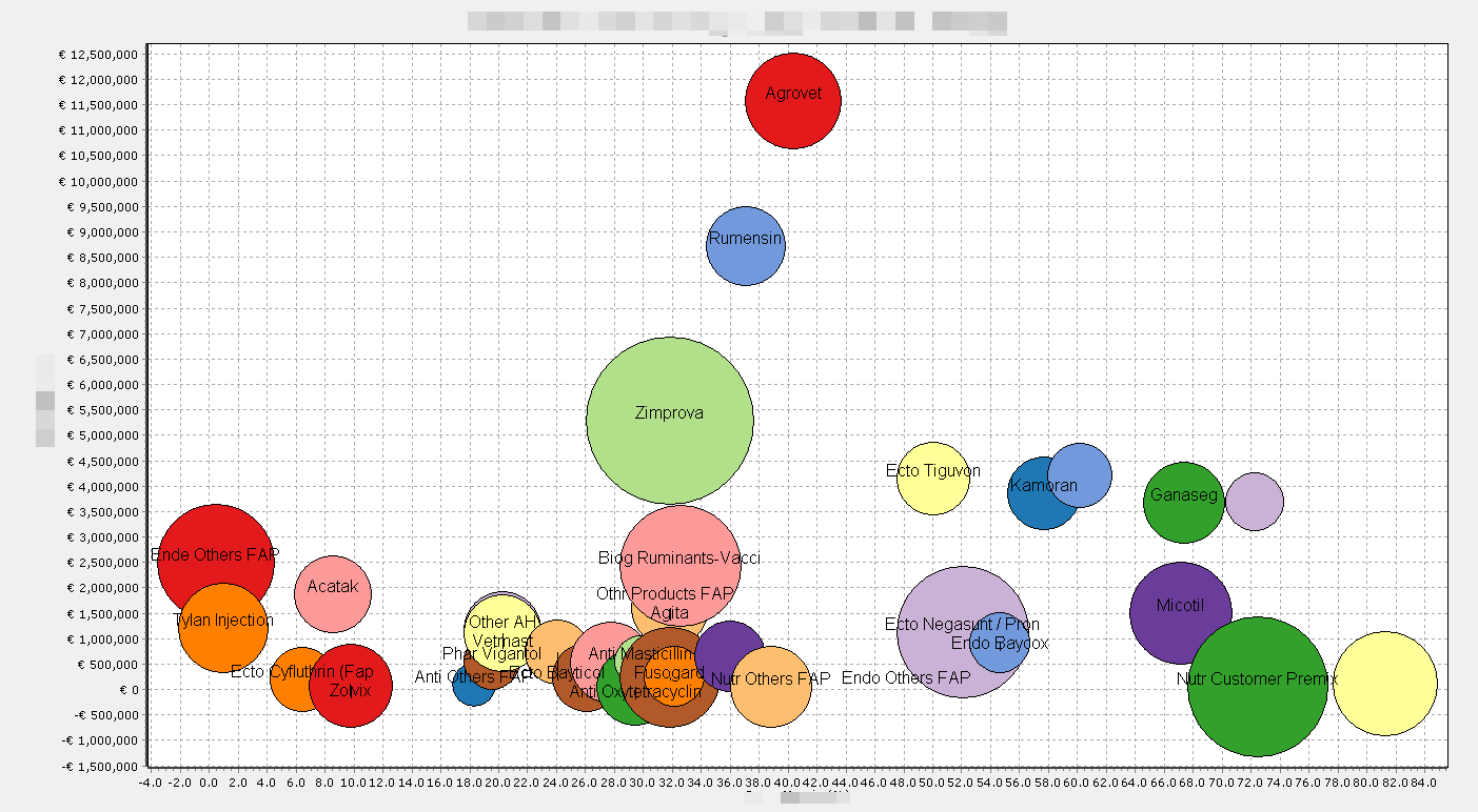

I have a bubble chart with marks visible. The text is not visible for all of the bubbles (see attached image). I assume this is due to some overlapping-text algorithm How can I force the text to be visible for all bubbles?

Yes you can disable it as follows:
  Series1.Marks.AutoPosition:=False;
