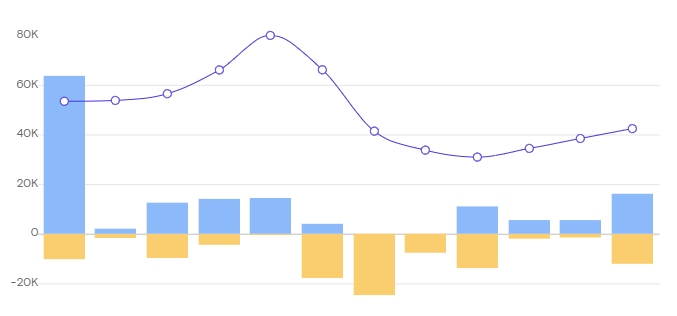

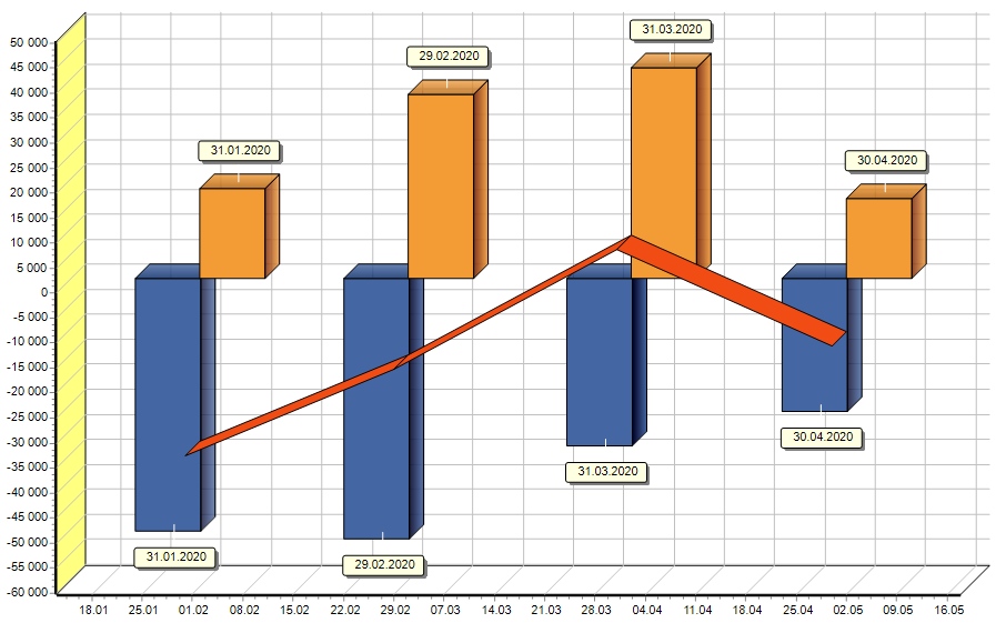

I am creating the Current.jpg bargraphs programmatically in Delphi Rio and display them in Fast-Report VCL. I haven't found a way to stack two bars on the same X position like in Goal.jpg screenshot..
Is this possible using my version of TeeChart? If yes, can I also smooth my red Current.jpg curve graph so it looks more like the blue one in Goal.jpg..?

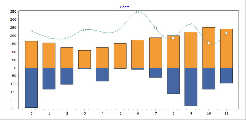

Here a simple example:
You basically need to set the TBarSeries MultiBar property mbStacked and use an additional TLineSeries with a TSmoothingFunction to show a smoothed line while still showing only a few (source) points:
uses Series, TeeSpLine;
var i,j: Integer;
    SourceSeries: TPointSeries;
    SmoothSeries: TLineSeries;
    SmoothFun: TSmoothingFunction;
  Chart1.View3D:=False;
  Chart1.Color:=clWhite;
  Chart1.Legend.Hide;
  Chart1.Axes.Bottom.Grid.Hide;
  Chart1.Axes.Left.Grid.Hide;
  for i:=0 to 1 do
      FillSampleValues(12);
      MultiBar:=mbStacked;
      Marks.Hide;
      if i=0 then
        for j:=0 to Count-1 do
            YValue[j]:=-YValue[j];
  SourceSeries:=TPointSeries.Create(Chart1);
  with SourceSeries do
    Pointer.Show;
    Pointer.Color:=clWhite;
    Pointer.Style:=psCircle;
  SmoothSeries:=TLineSeries(Chart1.AddSeries(TLineSeries));
  with SmoothSeries do
    ShowInEditor:=False;
    ShowInLegend:=False;
    SmoothFun:=TSmoothingFunction.Create(Chart1);
    SmoothFun.Interpolate:=True;
    SmoothFun.Factor:=8;
    SetFunction(SmoothFun);
    DataSource:=SourceSeries;
  Chart1.AddSeries(SourceSeries);
  SmoothSeries.Color:=SourceSeries.Color;
  SourceSeries.Pointer.Pen.Color:=SmoothSeries.Color;
