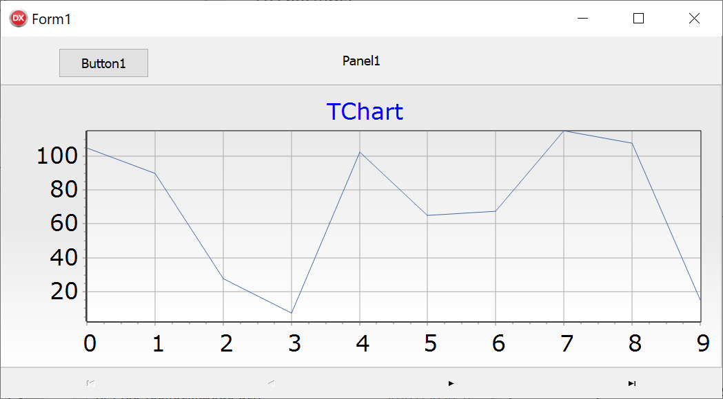

When scaling up my display to 175% for High DPI testing, I notice that the TChartPageNavigator buttons are not scaling up at all; they remain the same size as at a 100% scaling factor. I'm using Delphi Rio 10.3.3 with W10 Pro and the latest TeeChartVCLFMXSOURCE-2020.30 update. Is there any way of using the TChartPageNavigator with a TVirtualImageList to correct this problem? Or do you intend to fix the problem?

This is how it looks for me at 175%:
I've added it to the public tracker #2348

Thanks Yeray. If you look at the tiny page navigation buttons at the bottom and their large spacing, you will see what I mean.

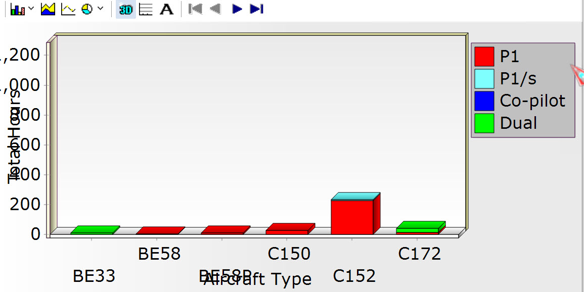

This is what I expect to see at 175% - with my Page navigator code. Also, I've just noticed that the left and bottom legends overlap with the values. Not sure if that is a TChart problem or something I can fix.
TChartPageNavigator buttons.jpg (102.09 KiB) Viewed 45044 times
I mean the LH and Bottom titles overlap.

It looks as though TChart doesn't scale up properly with the axis titles not adjusting the distance between them and the axis labels as shown in my image above. Can you suggest a workaround or will it need a fix?

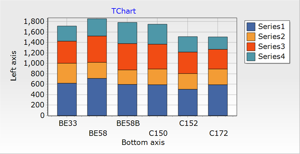

It seems to work fine for me (the image is in 2D but I've also tried in 3D, in Rio and Sydney):

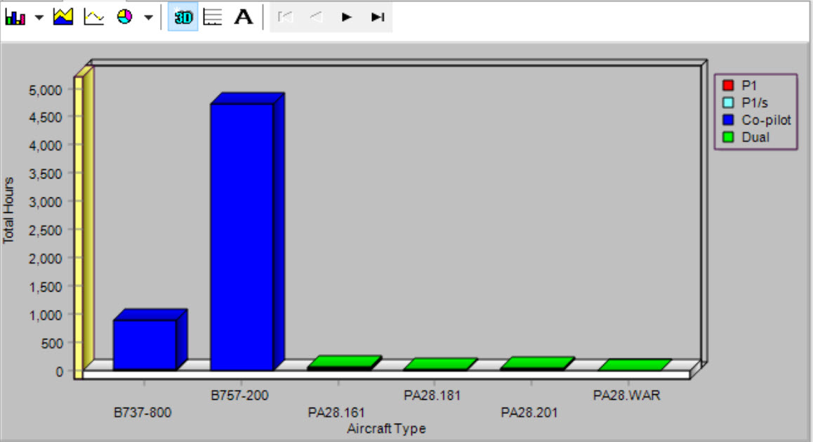

Not making any progress with this. Comparing the app compiled in D2007 and 10.4 Sydney in W10 Pro at a display scaling of 175% (with different data) you see:
The units generating both images are identical - just different compilers. As you can see, no scaling in the D2007 image but huge scaling in the 10.4 one. Look at the size of the font in it! As I have said, there seem to be similarities with Issue: 'Display settings and font size'. BTW, I am using my own navigator buttons in the 10.4 image which scale correctly; yours don't.
