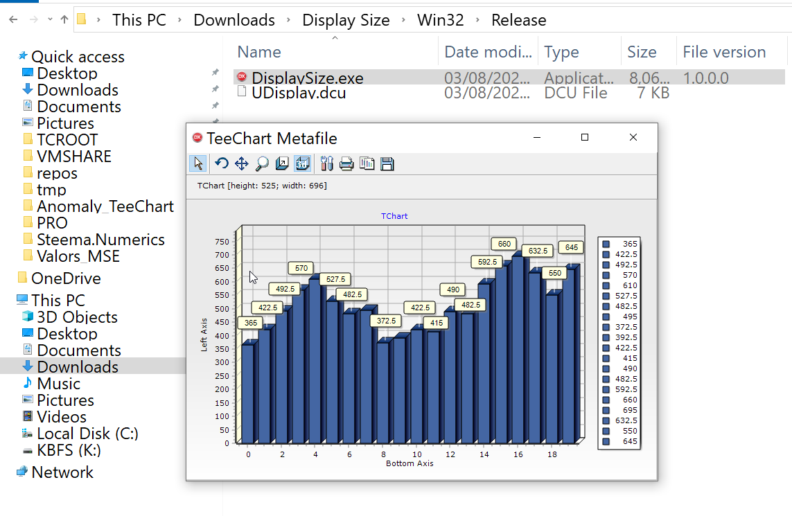

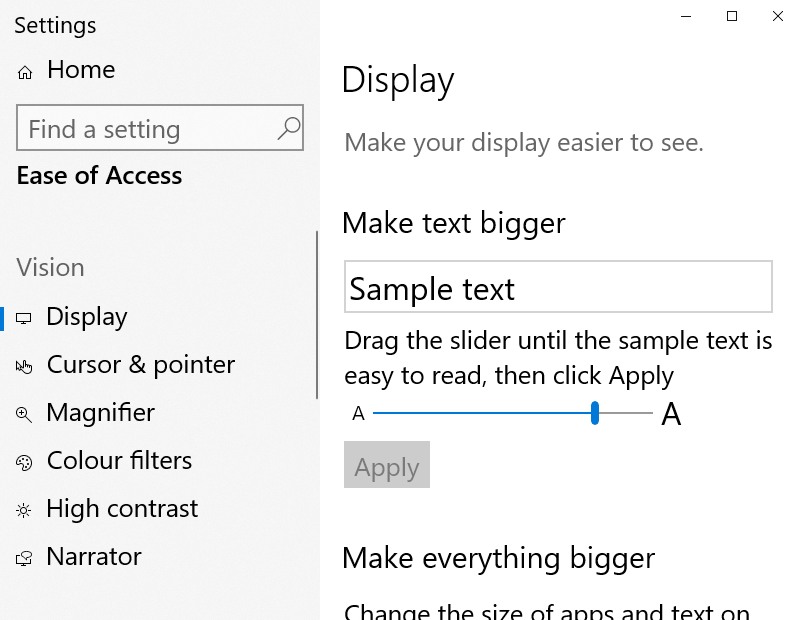

I'm not sure if I'm doing this right - I compile your project in release mode, then I change the display font size like this:
Then I run the exe and get this:
Could you please confirm or otherwise correct me on whether I'm doing this right?
