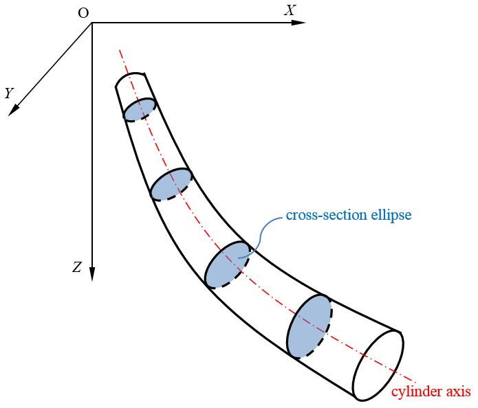

The axis of an elliptic cylinder is a 3D curve, and its cross section at any position is an ellipse. The 3D curve and a series of cross-section ellipses are known. That is to say, we know the 3D coordinates of the curve and ellipses at any position. I have no idea to draw the elliptic cylinder. Would you like to give me an example? Thanks a lot.

I'm afraid there's no series or tool implemented in TeeChart doing this for you, but once you have the data, it should be possible to use a TSurfaceSeries or a TPoint3DSeries to draw it.
