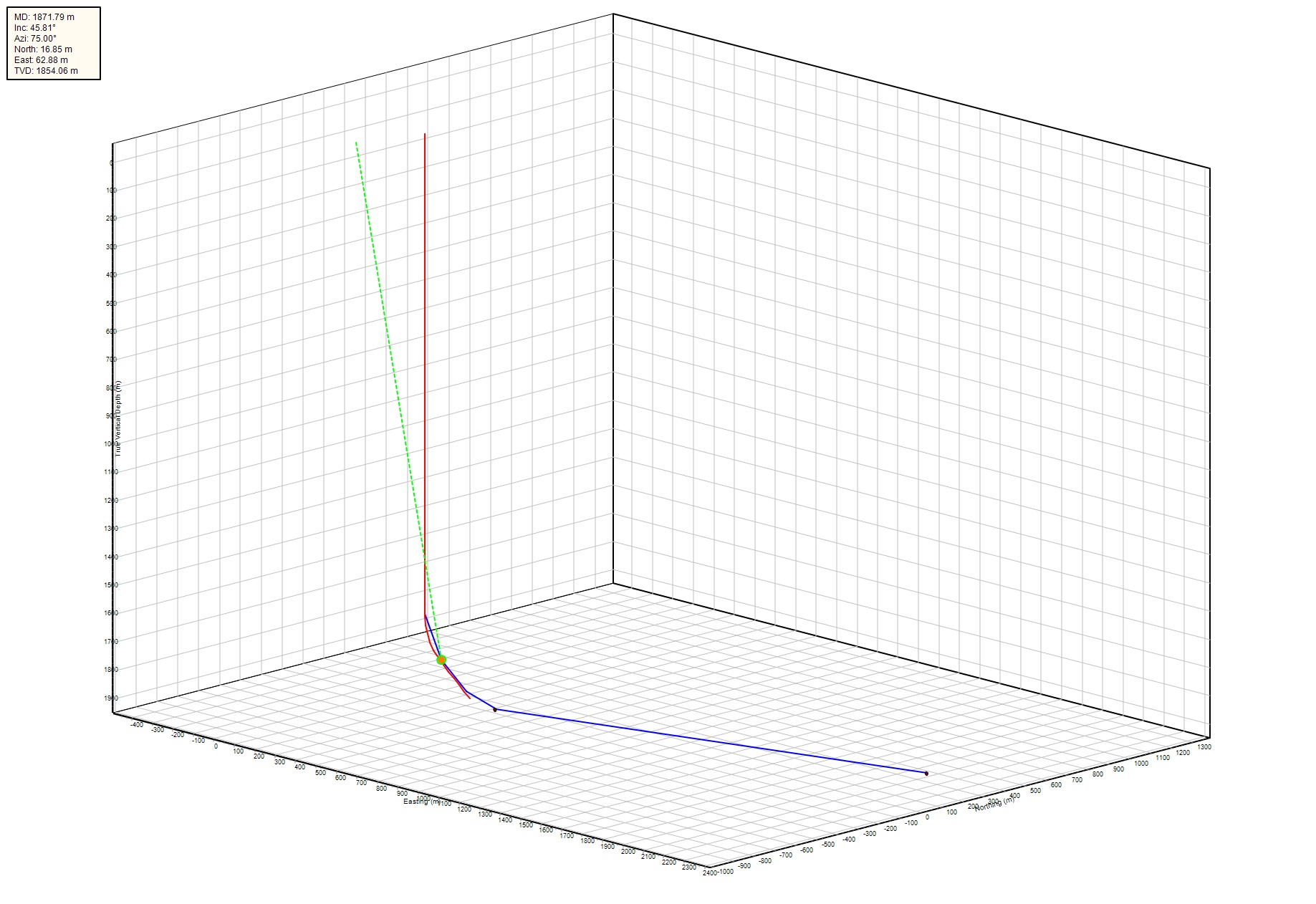

1. The Callout does not draw a line from THE ANNOTATION.
2. Axis’s Titles are not in the right positions and angles.
Please help me with these problems. Thanks!

Could you please detail how would you expect both things to be drawn?

Post by xsLiu » Fri Sep 18, 2020 2:00 am
Please find attached.
I've reproduced it so I've added it to the public tracker:
http://bugs.teechart.net/show_bug.cgi?id=2372
Take a look at the discussion and code here.
