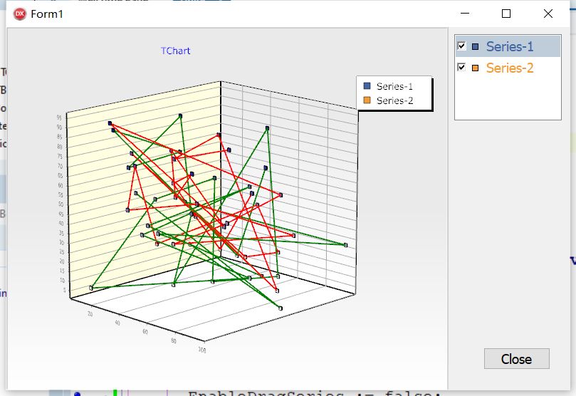

I hope to show Titles using the same Color with its corresponding Series in a ChartListBox, but Title‘s Color is not consistent with SeriesColor in ChartListBox.
  with aChartListBox do
      Chart := aChart;
      EnableChangeType := false;
      EnableChangeColor := true;
      EnableDragSeries := false;
      ShowSeriesIcon := false;
      ShowActiveCheck := true;
      ShowSeriesColor := true;
      ShowSeriesTitle := true;
      FontSeriesColor := true;
      AllowDeleteSeries := false;
      AllowAddSeries := false;

Please find attached.
Point3D.zip
(54.15 KiB) Downloaded 1504 times
Re: Title‘s Colors in ChartListBox
Post by Yeray » Thu Oct 01, 2020 6:30 am
You are setting the series LinePen.Color, which is ok for the lines connecting the 3d points, but you should set the main series' Color.

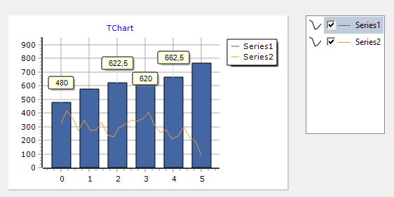

Post by xsLiu » Mon Sep 27, 2021 4:41 am
How to change the Color tag/band (between ActiveCheck and SeriesTitle) from “square” to “line”?

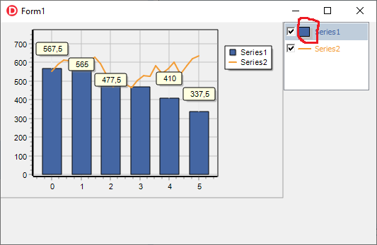

Post by xsLiu » Mon Sep 27, 2021 9:02 am
Please find the attached file and the hand tag.
Post by Yeray » Mon Sep 27, 2021 9:36 am
Depending on the series style it will be changing the Series' Pointer.Color, or just the Series' Color. Ie
TBarSeries(Chart1[0]).Color:=clRed;
TPoint3DSeries(Chart1[0]).Pointer.Color:=clRed;

Post by xsLiu » Mon Sep 27, 2021 2:00 pm
I want to change its shape shown in the ChartListBox, not color.

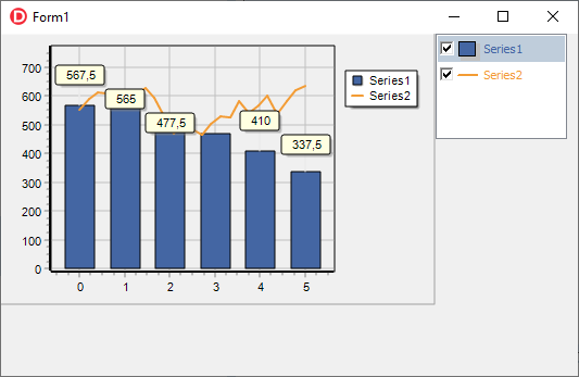

In that case you could use a dummy TLineSeries - which symbol is drawn as a "line" when in 2D - and hide the TBarSeries - which is drawn as a "square" when in 2D - from the legend and editor. Ie:
uses Series;
  Chart1.View3D:=False;
  Chart1.Color:=clWhite;
  Chart1.Walls.Back.Visible:=False;
  with Chart1.AddSeries(TBarSeries) do
    FillSampleValues;
    ShowInLegend:=False;
    ShowInEditor:=False;
    Title:='Series1';
  //dummy series for the legend
  with Chart1.AddSeries(TLineSeries) do
    Title:=Chart1[0].Title;
    Color:=Chart1[0].Color;
    FillSampleValues;
    Title:='Series2';
  ChartListBox1.Chart:=Chart1;
