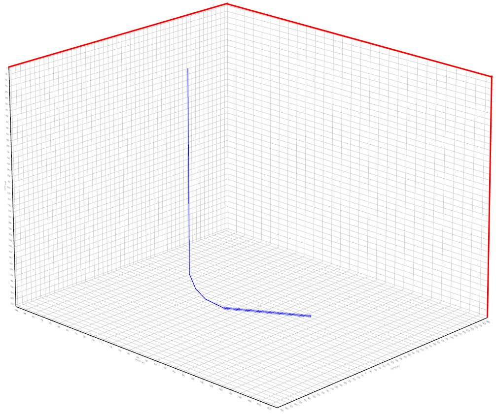

I want to have “AutoHide” Walls with Frame (see Red Lines in attached pictures). The code used as follows:
      with Walls do
          Visible := true;
          View3DWalls := false;
          Left.Visible := true;
          Left.AutoHide := true;
          Bottom.Visible := true;
          Bottom.AutoHide := true;
          Back.Visible := true;
          Back.AutoHide := true;
          Right.Visible := false;

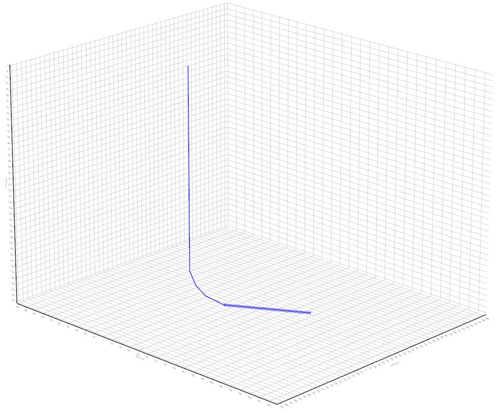

1. When View3DWalls := false, Walls are AutoHide, but no Frame. When View3DWalls := true, the Chart shows Frame, but Walls are not AutoHide (except Walls.Back).
2. When Axis.Title.Caption use Chinese characters, they display in garbled code.
How to solve these problems?

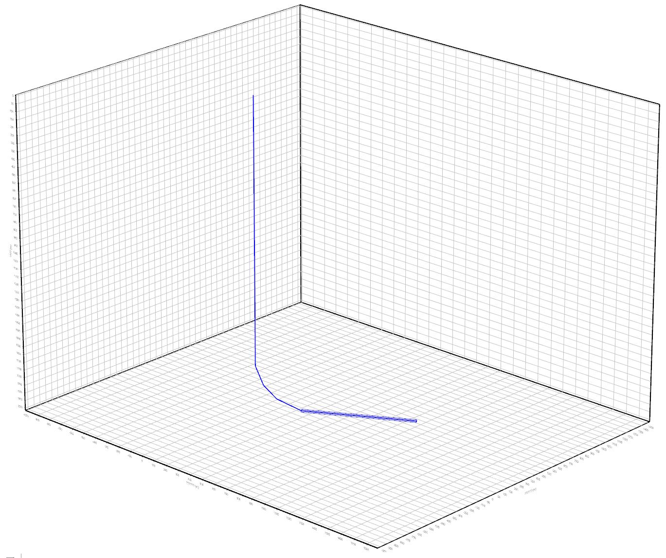

You can set the Left and Bottom Walls brush to bsClear:
with Walls do
  Left.Brush.Style:=bsClear;
  Bottom.Brush.Style:=bsClear;
