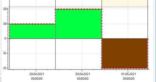

I need area series with two colours. One for negative and one for positive areas. (See attached screenshot for details)
I've done that by using OnAfterAdd:
void __fastcall MyFlowRateRectangleSeries::OnAfterAddPoint(TChartSeries *Sender, int ValueIndex)
	if(Sender->YValues->Value[ValueIndex] > 0)
	 Sender->ValueColor[ValueIndex] = DefaultPosColor;
	 Sender->ValueColor[ValueIndex] = DefaultNegColor;
but it doesn't work automatically, only if I call OnAfterAdd in code:
NewSeries->AddXY(XValue, YValue);
NewSeries->OnAfterAdd(NewSeries, Index); //OnAfterAddPoint doesn't work without that line
also I want to apply new colours by pressing button, I need to redraw chart in OnClick handler for that?
