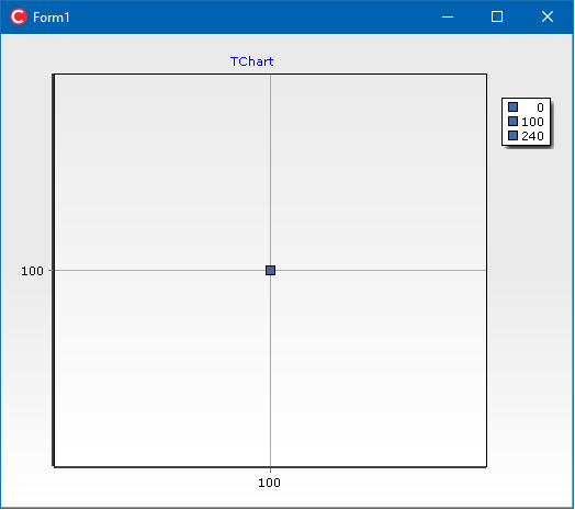

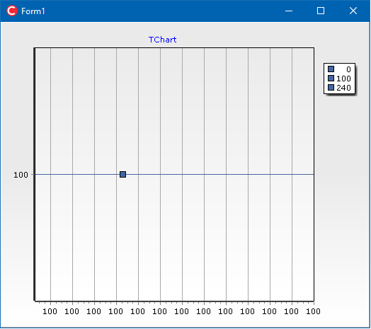

Then I zoomed about 24 times, I have only horizontal line. If i try to zoom in again only one point remains. Line can be vertical as well.
First image - test line on chart
Secons - line after 20+ zooms

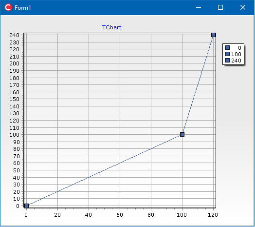

Third - the last zoom
