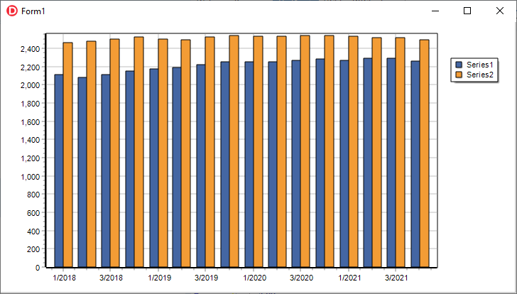

I have multiple Memtables fetched from Database. Each of which contains records for one year.
I have added series to the DBChart with those memtables as Datasource (Summary grouped by Quarter).
Now i have the problem that the values for the different years are grouped by year. I would like to have for each quarter of all years next to each other. So that for example a comparison of Quarter 1 of 2020 and 2021 is possible. (Those to Quarters next to each other in a Bar Series)
Is there a way to do this?
Thanks in advance for the help
Max

If I understand your situation, you probably have something like this:
uses DBChart, Series, DateUtils;
var Chart1: TDBChart;
    memTables: array of TFDMemTable;
var i, j: Integer;
    val: Integer;
    date: TDateTime;
  Chart1:=TDBChart.Create(Self);
  Chart1.Parent:=Self;
  Chart1.Align:=alClient;
  Chart1.View3D:=False;
  Chart1.Color:=clWhite;
  SetLength(memTables, 2);
  for i:=0 to Length(memTables)-1 do
    memTables[i]:=TFDMemTable.Create(Self);
    memTables[i].FieldDefs.Add('Date', ftDateTime);
    memTables[i].FieldDefs.Add('Price', ftInteger);
    memTables[i].CreateDataSet;
    memTables[i].Open;
    val:=2000+Random(500);
    date:=StrToDateTime('01/01/2018');
    for j:=0 to (365*4)-1 do
      memTables[i].AppendRecord([date, val]);
      date:=IncDay(date);
      val:=val+Round(Random(10)-4.5);
    with Chart1.AddSeries(TBarSeries) do
      Marks.Hide;
      DataSource:=memTables[i];
      YValues.ValueSource:='#AVG#Price';
      XLabelsSource:='#QUARTER#Date';
In that case, you should be able to create auxiliar memTables for each year and show them instead of the original tables.
