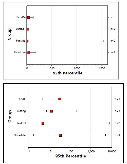

I am using an ErrorPointSeries to display a statistic by "group" and the lower and upper confidence limits. The code is below
Series1 is a TErrorPointSeries
for i:=0 to N-1 do begin
  Series1.Add( Stat[i], i+1, Statistic[i] - LCL[i], UCL[i] - Statistic[i], 0,0);
  chart1.Axes.Left.Items.Add( i+1, Name[i] );                      // add group name to Y-axis
  chart1.Axes.Right.Items.Add(i+1, 'n='+IntToStr( N[i]) );  // add Ni to right Y-axis
The error bars show as expected ( see first chart). When I change the x-axis to logarithmic the markers are correctly positioned, but the lower and upper error bars have changed (see second chart).
Any suggestions?

Post by Yeray » Wed Dec 15, 2021 1:25 pm
I've been able to reproduce the problem and I've already fixed it for the next release (#2491).
Since you own the sources, you can apply the fix to your copy. Find below the diff:
 TeeErrorPoint.pas | 8 ++++----
 1 file changed, 4 insertions(+), 4 deletions(-)
