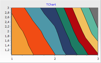

A and C look the same. Are you sure this is correct?
A contour with A, B and D looks like this:
  Series1.AddXYZ(1, 5, 1);
  Series1.AddXYZ(2, 10, 1);
  Series1.AddXYZ(3, 20, 1);
  Series1.AddXYZ(1, 6, 2);
  Series1.AddXYZ(2, 12, 2);
  Series1.AddXYZ(3, 25, 2);
  Series1.AddXYZ(1, 8, 3);
  Series1.AddXYZ(2, 15, 3);
  Series1.AddXYZ(3, 28, 3);
Deppending on the data, you may need to add this (but with the data above it isn't necessary):
  Series1.IrregularGrid:=True;

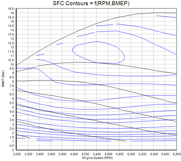

Here is a bit more background: I am trying to create this chart:
The black lines in the contour chart are constant Throttle values and a regular grid of sfc=f(Throttle,RPM) is available. Also, BMEP ("Z" in the contour map) is known at each RPM and Throttle operating point. Data outside of the Throttle-RPM range cannot be reliably calculated. It is obviously possible (without too much effort) to filter out any points in a BMEP-RPM grid outside the valid throttle range, but the result is very ragged at the top edge (as you can see). Improving this is more difficult, hence my question about entering a Throttle-RPM grid into a BMEP-RPM chart.

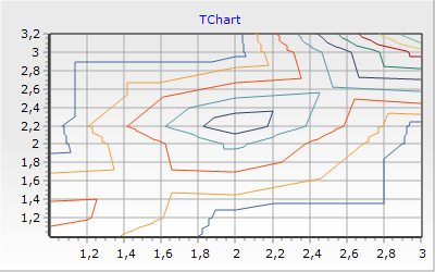

We've been playing with your data and got to the idea of filling the gaps with 0s (or -1s).
Then, we'd modify the first UpToValue in Levels so the gaps aren't drawn:
  Series1.Filled:=False;
  Series1.AddXYZ(1, 5, 1.0);
  Series1.AddXYZ(2, 0, 1.0);
  Series1.AddXYZ(3, 0, 1.0);
  Series1.AddXYZ(1, 0, 2.0);
  Series1.AddXYZ(2, 10, 2.0);
  Series1.AddXYZ(3, 0, 2.0);
  Series1.AddXYZ(1, 0, 3.0);
  Series1.AddXYZ(2, 0, 3.0);
  Series1.AddXYZ(3, 20, 3.0);
  Series1.AddXYZ(1, 6, 1.1);
  Series1.AddXYZ(2, 0, 1.1);
  Series1.AddXYZ(3, 0, 1.1);
  Series1.AddXYZ(1, 0, 2.1);
  Series1.AddXYZ(2, 12, 2.1);
  Series1.AddXYZ(3, 0, 2.1);
  Series1.AddXYZ(1, 0, 3.1);
  Series1.AddXYZ(2, 0, 3.1);
  Series1.AddXYZ(3, 25, 3.1);
  Series1.AddXYZ(1, 8, 1.2);
  Series1.AddXYZ(2, 0, 1.2);
  Series1.AddXYZ(3, 0, 1.2);
  Series1.AddXYZ(1, 0, 2.2);
  Series1.AddXYZ(2, 15, 2.2);
  Series1.AddXYZ(3, 0, 2.2);
  Series1.AddXYZ(1, 0, 3.2);
  Series1.AddXYZ(2, 0, 3.2);
  Series1.AddXYZ(3, 28, 3.2);
  Series1.CreateAutoLevels;
  Series1.Levels[0].UpToValue:=1;

Yes, that is pretty much what I did to create the sfc chart I posted previously. My problems are
1) it is computionally intensive to identify the null points (above 100% throttle)
2) the top edge of the contour map is rather ragged, even with reasonably close spacing on the grid. The 100% throttle contour line is never shown and I had to add it using a single XY series line.
3) there is a significant amout of "unecessary" pre-processing to create the X-Z grid required by the TeeChart contour series.
My ideal solution is to allow an fully irregular X-Z data entry and then trangulate the contour series (which is what I am used to in TecPlot). I now understand that this is not currently possible wth TeeChart, but it would be nice if this were to be inluded on a wish list for new features.
