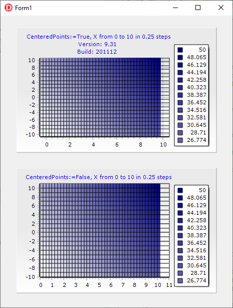

I am using TColorGridSeries with IrregularGrid:=True. We use CenteredPoints:=True. When the X axis steps are less than 1, there is an offset between the axis plotted and the data. I think this is related to http://www.teechart.net/support/viewtop ... 06&p=30478 and http://bugs.teechart.net/show_bug.cgi?id=841, but does not appear to be fixed in TeeChart VCL 2020.31. We have TeeChart Pro with source code.
The example below shows the expected behaviour when CenteredPoints:=False, but the data plotted is offset to the left compared to the axis when CenteredPoints:=True. From a brief test, it appears that 0.5 is subtracted from the data internally to implement the CenteredPoints plotting, which is incorrect if the X data step isn't 1.
Illustration:

  // With CenteredPoints enabled, the resulting plot is offset compared to the
  // axis. It seems as if internally, 0.5 is subtracted from the X value for
  // CenteredPoints:=True, which is fine if the X spacing is 1, but not otherwise
  // See http://www.teechart.net/support/viewtopic.php?f=4&t=7706&p=30478

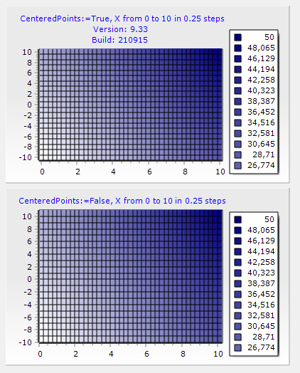

I've just fixed #841 for the next maintenance release which we'll be releasing soon.
This is how your example looks with it:
