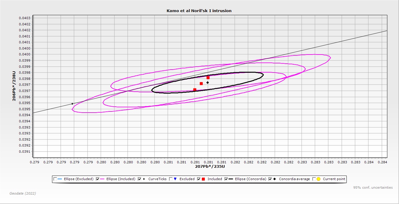

Hi
I generate some graphs with elliptical boundaries around data points (see attachment with magenta ellipses). These ellipses represent, say, 1 sigma uncertainties for individual data points. I would like to be able to colour the interior of each ellipse, with variable opacity and maybe gradient according to values in some other variable in a dataset.
Please could you advise me whether there is currently any option in TeeChart to fill inside some calculated/defined boundary (like the ellipses in the attached image) and whether it would also be possible to colour according to a third data variable?
Any advice for how to achieve this (if possible with current versions of TeeChart) would be much appreciated.
Bruce

Post by Marc » Fri Apr 08, 2022 2:56 pm
Hello Bruce,
You could take the point values that you use to plot the data, converting them to pixel locations using:
Series1.CalcXPosValue(value) and Series1.CalcYPosValue(value)
..or loop through the indexes of the points using:
Series1.CalcXPos(idx) and Series1.CalcYPos(idx)
..and adding them to an array of TPoints. You can then plot the array in the OnAfterDraw event using:
Chart1.Canvas.Polygon(yourArray);
Before you plot the polygon, set the Brush to fill as you require.
eg.
  Chart1.Canvas.Brush.Gradient.StartColor := clRed;  //can use (a)rgb colours
  Chart1.Canvas.Brush.Gradient.EndColor := clYellow;
  Chart1.Canvas.Brush.Gradient.Visible := True;

Post by Bruce » Tue Apr 12, 2022 8:59 pm
Thanks. I am missing something though and am not sure what the associations are.
What is the array definition meant to be? is it something like
MyArray : array of TPoint;
or should this be TPoints, in which case TPoints must be defined in some unit I am not aware of.
When adding the pixel location data to the array, I presume that this should be something like
for i := 1 to N   // N is count for existing Series dataset
  MyArray[i].Create(Xloc,Yloc);
but this does not seem to work.
Any help would be much appreciated

Post by Marc » Tue Apr 19, 2022 8:10 am
Hello Bruce,
This example would go some way to the goal, proof of concept. You can make adjustments as necessary:
var i : Integer;
    myPoints : Array of TPoint;
  SetLength(myPoints, Series1.Count);
  for i:= 0 to Series1.Count-1 do
  Begin
    myPoints[i] := TPoint.Create(Series1.CalcXPos(i),Series1.CalcYPos(i));
  End;
  Chart1.Canvas.Polygon(myPoints);
