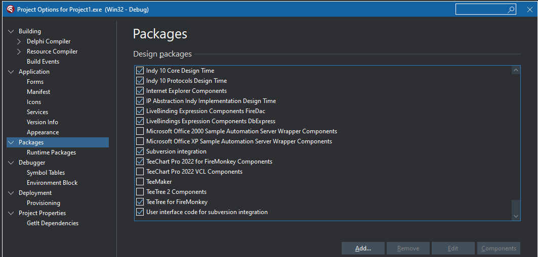

We are migrating our code to Delphi 11.1 Alexandria from Delphi 10.1 Berlin. We used Steema's TeeChart in 10.1, but got the updated VCL installation program. (TeeChartVCLFMX-2022.35.exe). After completing the installation, and opening Delphi 11.1, I get errors (see attached picture). The previous topic i read got pretty much the same error, and seemingly "fixed" the issue by upgrading to 11.1 from 11.0. However, we were already up to date to 11.1 before installing TeeChart. I have tried running the installer exe as administrator, without any change. Checking Delphi's Packages Options list in a project, it can recognize the TeeChart options are available (see picture), but checking the box for "TeeChart Pro 2022 VCL Components", we get the same sort of error. I saw in the other topic that there was an installation error that prompted us to copy a backup of certain files. I got that too, and put back those backed up files before trying the install program again, but that did not work for us.
Can you offer any other ideas about dealing with these errors? Is there anything involving 32 bit vs. 64 bit when it comes to installing TeeChart that would cause a problem? Does the fact that we are currently running both Delphi 10.1 and 11.1 on the same computer at the same time cause a confusion to the installer?

The thing is there's another package referencing "Tee9280", which is the TeeChart Standard/Lite that was shipped with the IDE.

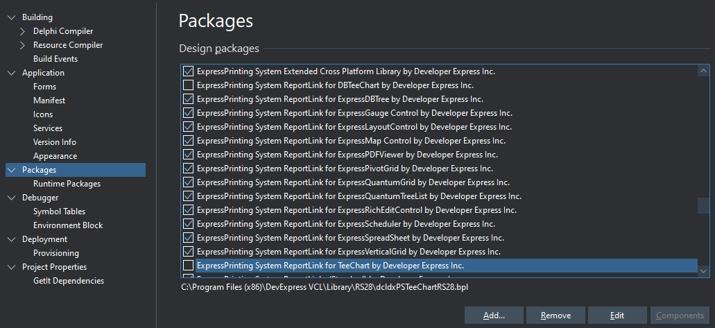

Thank you for replying to my question. It appears your solutions were on the right track. Just in case it helps anyone else out there, my errors seems to disappear after clearing the checks for the Developers Express packages for ExpressPrinting as seen in the attached picture. I was prompted after clearing the check that a couple package names were no longer associated with any installed package (namely "tee" and "teedb" i believe). I said yes to the prompt to have them uninstalled as well. I was then able to click the checks for the newly installed TeeChart Pro packages.
