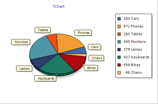

I have a procedure updating the Legend[].item.text value in order to make the Legend more readable. However, it seems that the legend items can then overlap each other. Can I refresh the legend to update item positions or manually set the required length of the legend items?

Have you tried setting Legend.VertSpacing?
Ie:
  Chart1.Legend.VertSpacing:=10;
