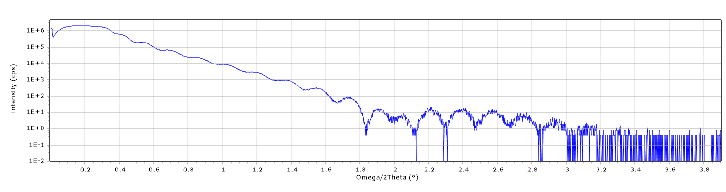

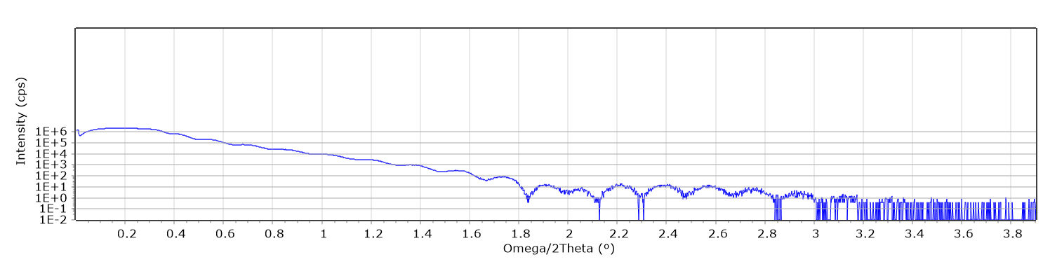

I have seen this as well, logarithmic scaling has changed from 2022.35 to 2022.36. See the attached images.
Version 2022.36
Plot 2022_36.png (36.75 KiB) Viewed 15621 times
Version 2022.35
Plot 2022_35.png (44.79 KiB) Viewed 15621 times

I could reproduce the problem so I've added it to the public tracker (#2564) and also fixed it for the next release.
