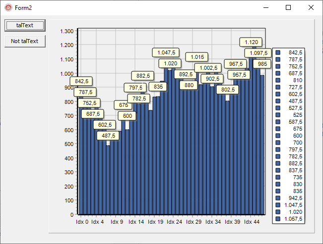

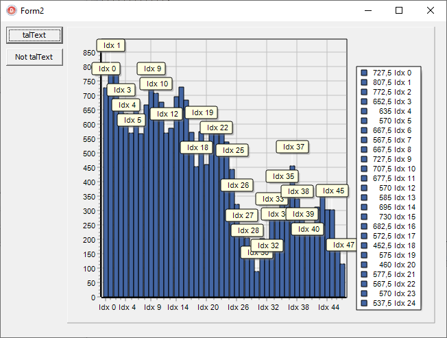

LabelStyle talText forces the axes to show the labels from the first series assigned to the axis. However, in that example you have no labels in your series. That's why no labels are drawn.
Assigning labels to the series, you don't even need to use
OnGetAxisLabel
event:
procedure TForm2.Button2Click(Sender: TObject);
var
Rect: TRect;
i: Integer;
Chart := TChart.Create(Self);
Chart.View3D := False;
Chart.BottomAxis.LabelStyle := talText;
//Chart.OnGetAxisLabel := ChartGetAxisLabel;
Chart.AddSeries(TBarSeries.Create(Chart));
Chart.SeriesList[0].FillSampleValues(48);
for i:=0 to Chart[0].Count-1 do
Chart[0].Labels[i]:='Idx '+IntToStr(i);
Rect := Image1.ClientRect;
Chart.Draw(Image1.Canvas, Rect);
Chart.Free;
Image1.Refresh;

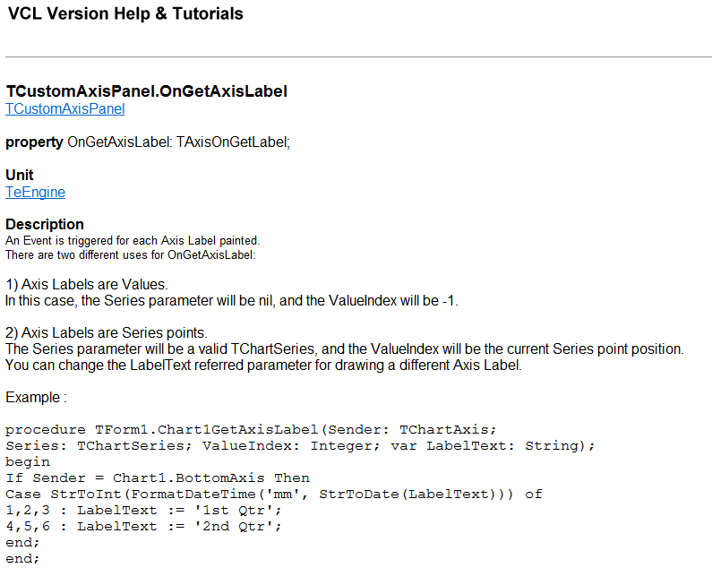

OK, further to my last post, I just checked the latest Help chm file I downloaded and the description for OnGetAxisLabel still matches what I am trying to do.
Surely this is a bug, as this function no longer works?
I can see my code assigning values to LabelText, as shown, but they do no appear.

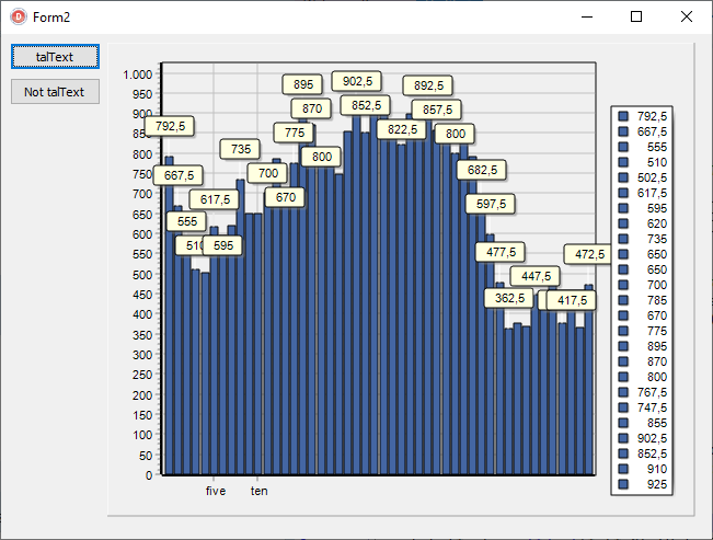

Hello Jamie,
I've been trying your test app with previous TeeChart versions (v2021.33 to v2022.36) with the same results. In what version do you find it behaved differently?
I'll be glad to investigate any braking change you may identify.
Indeed, if I add a custom item to the bottom axis,
OnGetAxisLabel
is not being fired, but the custom item is drawn, so you should be able to implement your algorithm with custom items. Ie:Code: Select all
var
Chart: TChart;
Rect: TRect;
//Chart.BottomAxis.LabelStyle := talText;
Chart.BottomAxis.Items.Add(5, 'five');
Chart.BottomAxis.Items.Add(10, 'ten');
Chart.BottomAxis.MinorTicks.Hide;
Chart.Free;
Image1.Refresh;
