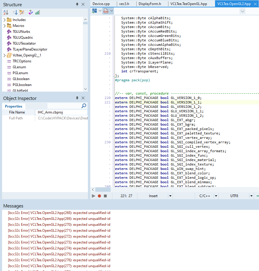

I attempted to add the component and use it for the chart's canvas. Upon compile, I get about 500 errors like the ones attached. Am I missing an include or something?

Have you tried dropping a TTeeOpenGL component into the form? When I do this in a C++Builder project, the #include "VCLTee.TeeOpenGL.hpp" is automatically added to the .h in the active unit. This VCLTee.TeeOpenGL.hpp unit includes VCLTee.TeeGLCanvas.hpp unit, which includes VCLTee.OpenGL2.hpp.

Hello Yerah,
Yes, there is a component on the page already. I set the component's Chart property to the TChart in use and the TChart's drawing setting to 3D OpenGL also.

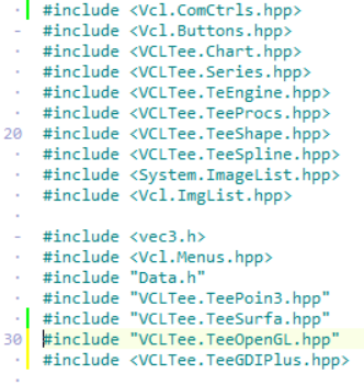

Here are my includes:

Hello John,
Have you tried it in a new simple project?
