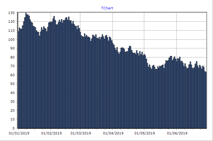

I would like to change the increment step on X Axis
that has every single day from 2019 year.
Hence, the X axis has a Date Format & I would like
to have an one month step for each Bar on graph.
Thank you
Vasilis

Hello Vasilis,
You could set the Increment to DateTimeStep[dtOneMonth]. Ie:
uses Series;
var i: Integer;
    d: TDateTime;
  Chart1.View3D:=False;
  Chart1.Color:=clWhite;
  Chart1.Legend.Hide;
    Marks.Hide;
    XValues.DateTime:=True;
    d:=EncodeDate(2019, 1, 1);
    AddXY(d, 100+random*10);
    for i:=1 to 30*6 do
      AddXY(d, YValue[i-1]+random*10-5);
      d:=d+1;
  Chart1.Axes.Bottom.Increment:=DateTimeStep[dtOneMonth];
