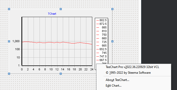

I just upgraded to the latest version and there is a bug in logaritmic axis max position (appears to be placed in the middle of the axis). I really need a quick fix for this!!!
Screenshot 2022-11-15 085955.png (10.33 KiB) Viewed 9142 times

I thing the issue can be found in line 5980 of TeEngine.pas, the following works ok
if FInverted then result:=Round((ILogMax-ln(Value))*(IAxisLogSizeRange))
                     else result:=Round((ln(Value)-ILogMin)*(IAxisLogSizeRange));
Can you pleae confirm this ok to keep?

Simply drop a TChart component and set Y axis to be logarithmic, minimum 1 and maximum 1000

This was identified and fixed a few weeks ago. Take a look at the fix here.
