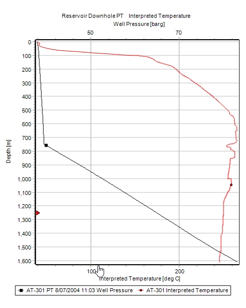

I use TeeChart to plot two data sets on a common axis - see Two_Graphs.jpg. The second graph uses custom axes.
When the top axis is used in one graph and the bottom axis in the other, I can merge the two graphs into a single graph. If I set the bottom axis LabelStyle to talNone, the legend is placed correctly, but the units popup does not work on the bottom axis - see Single_Graph_Correct_Legend_no_popup.jpg. If I set BottomAxis.Visible to false, the units popup is activated but the legend is misplaced - see Single_Graph_Legend_Misplaced.jpg.
Any help with this would be greatly appreciated.

I see no difference in the legend for all the screenshots you've posted. I assume you mean the bottom axis title.
Errol wrote:
Wed Nov 16, 2022 3:05 am
I'm not sure to understand. In that screenshot, I see the labels in the bottom axis.

I am sorry my explanation was not clear. In the merged chart, there are two overlaid axes, BottomAxis and CustomAxes[5].
In both cases, BottomAxis.LabelStyle is set to talNone.
If BottomAxis.Visible is True, the chart Legend is correctly placed below the BottomAxis title, but the units popup acts on BottomAxis and does not fire because there is no data associated with BottomAxis.
If BottomAxis.Visible is False, the units popup acts on CustomAxes[5] and fires correctly.. However, in this case. the chart Legend is not placed correctly, and obscures the BottomAxis title.
As far as I can see, I need show the BottomAxis to get the legend to be placed correctly. Is it possible to either place CustomAxes[5] on top of BottomAxis so the Units Popup is triggered by CustomAxes[5], or to associate the chart Legend with CustomAxes[5]?
I look forward to your comments.
Errol

I am pleased to report that I fixed the Popup problem by checking that the selected Popup had any items. If not, and if it was a dual graph, the Popup for the bottom axis of the second graph was called. It is all working fine now.
